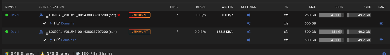

So when I install the second SSD that I was using for a cache (primary for VM's) Unraid shows both Devices as Dev 1 and seems to lump them together. Which is a bit confusing, in the HP bios I have each drive setup as a individual raid 0 in the same manner I have my whole array setup but the two SSD's for some reason show the same UUID.
Unraid shows them as sdf and sdh but the Id's are the same, is this whats causing the problem?
Yep, Unraid requires all devices to have a unique s/n.

when i look at the dev settings they have clearly different ids, is this a truncation problem with UD?
LOGICAL_VOLUME_0014380337D7200_3600508b1001c9d70bb2587130140cdbf (sdh)
LOGICAL_VOLUME_0014380337D7200_3600508b1001cf95ff760c0e4274362fa (sdf)
so they have different serials right? Unraid is just seeing them as the same UUID? Is t hat the correct terminology?
You can try posting in the UD support thread to see if there's anything that can be done, simple solution is to not use RAID controllers.
These are not actual serial numbers, just identifiers the RAID controller gives them.
