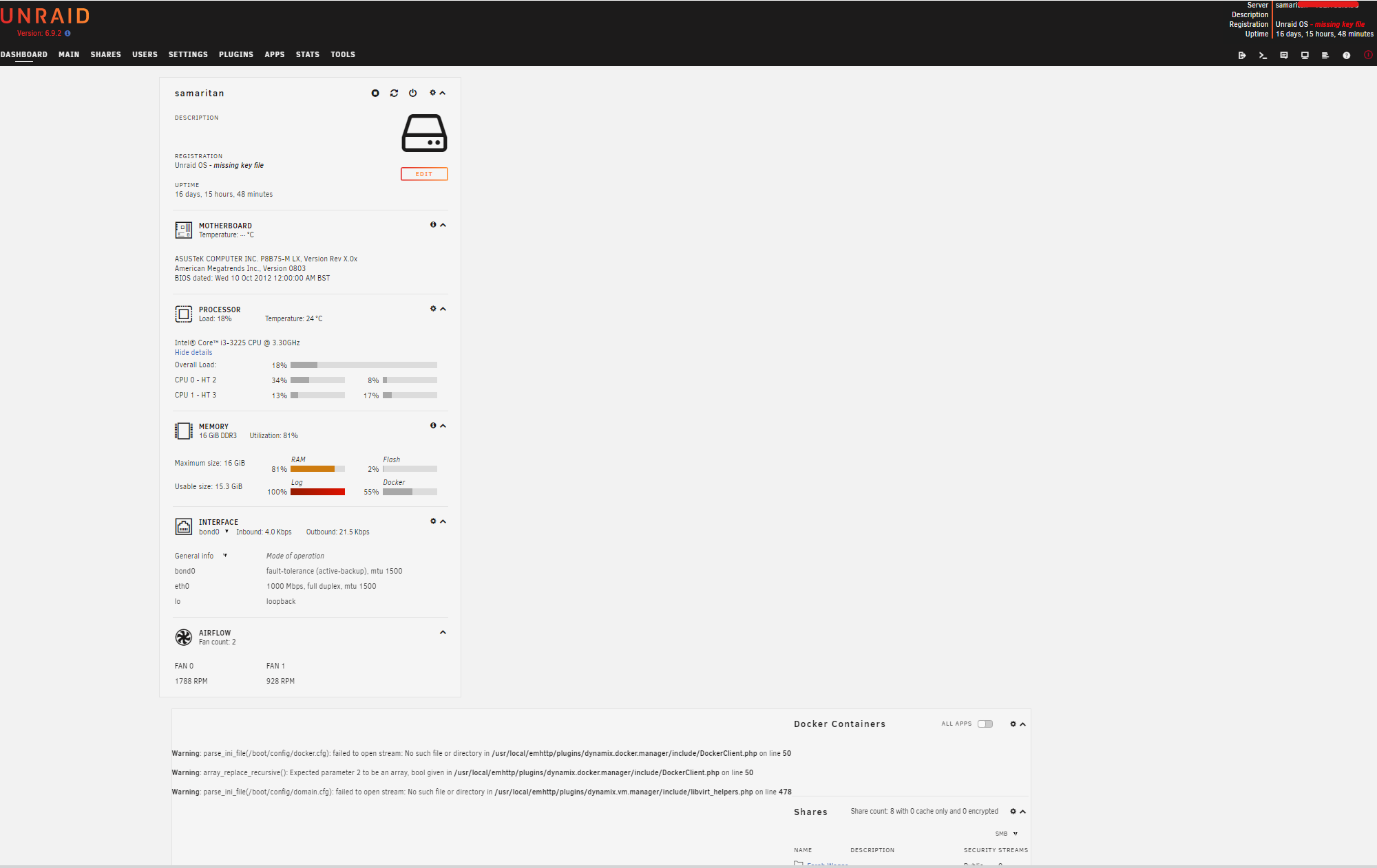

Every now and then, I'll log into the dashboard to start or stop a container.
When I get to the login page, it's a white background instead of my dark theme.
When I login, my dark theme is replaced with the stock white theme
The server information in the top right says "Unraid OS - Missing key file"
The dashboard has a bunch of php errors relating to docker
The docker tab is absent, but the containers are still running
The log usage shows 100% but when I try to open the log (logging.htm) the page just loads and timeouts eventually.
When I reboot, everything is back to normal, until the next time it (seemingly randomly) happens.

Syslog - I'll have to capture that the next time it happens. Unfortunately, I have no idea when it's going to happen. Before I replaced the USB, it would happen almost daily. Since replacing it a few weeks ago, this is the first occurrence. With the last USB, it progressively got worse until I had to shutdown with the power button because none of the controlled shutdown (ui, remote ssh, or local terminal) were actually shutting the system down.

In the meantime, it happened again.
This time, I grabbed the diagnostics.
samaritan-diagnostics-20220215-1605.zip
