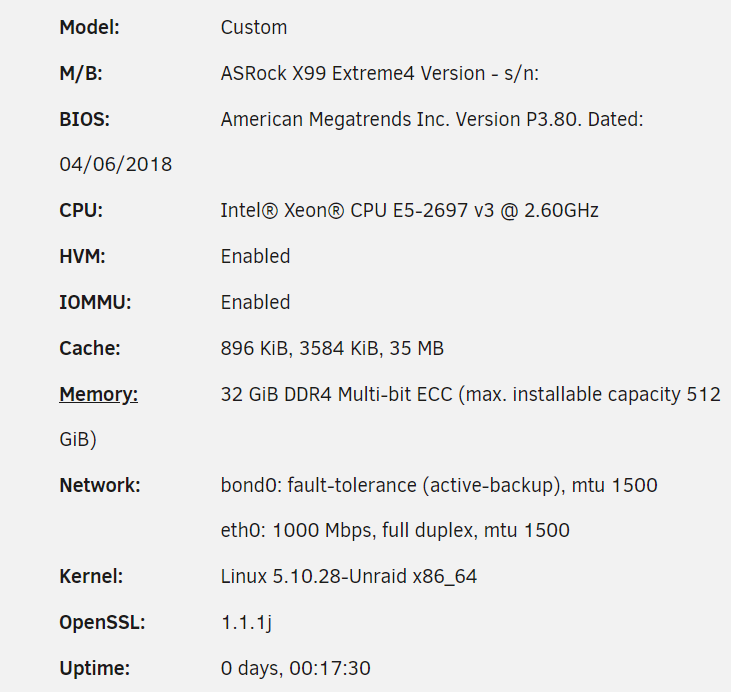

Hi i upgradeed my server to asrock x99 extrema 4(3.80 bios version) and 2697 v3 whit 32 gb ddr4 rdimm 2333 mhz and a have lot off crash when i want start win 10 vm 2th time since the host start. (1. vm start OK -> i stop vm OK no error log -> 2. vm start vm crash and the host unreachabel i need restart.) After crash the host server i need to enable vm in setting.

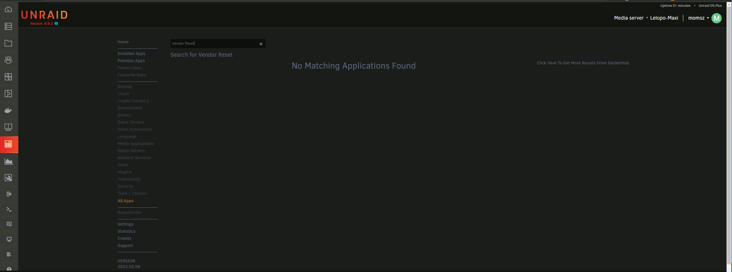

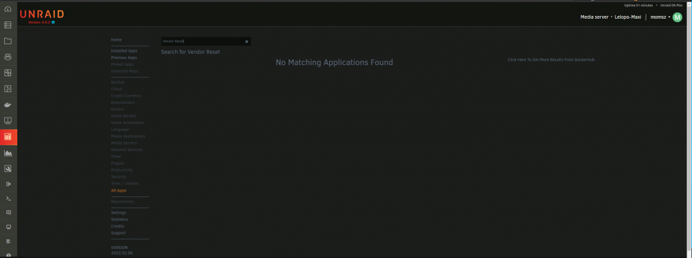

I don't find it
I need to update 6.10-rc2 ?
I update to 6.10 and instaled the vendore driver and i got this after instarted vm

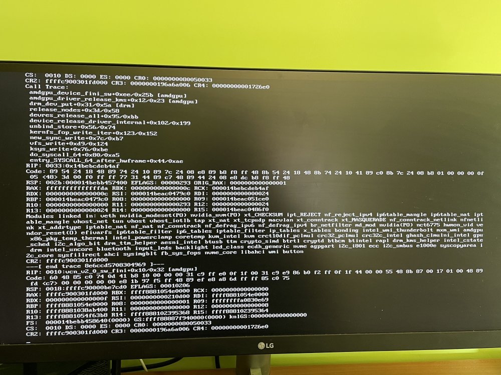

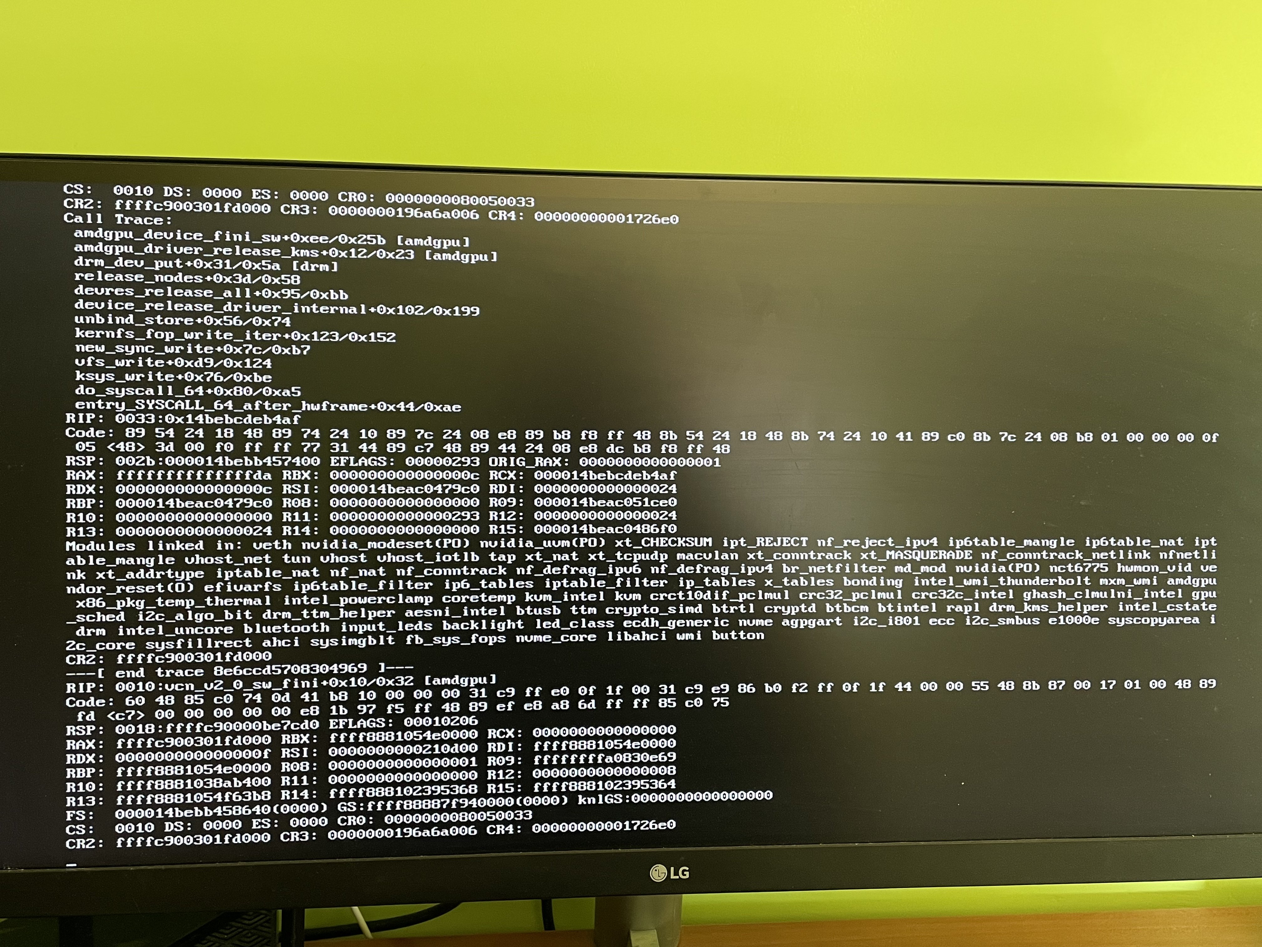

But when i resart the vm is it crashed and crashed the host to. i need to push resetbutton to restart becouse no gui and ssh and not response keyboard to.
This is my log before crash
