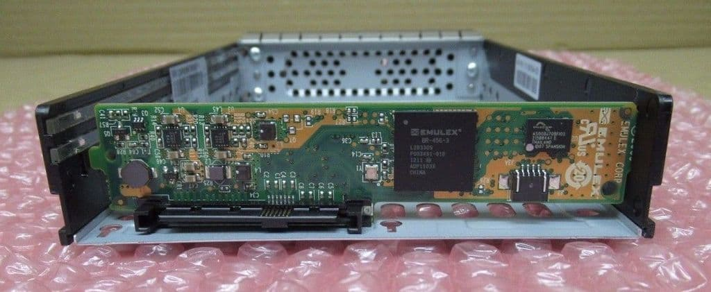

Interposers are the little board at the back of the caddys:
If you remove this the disks will been seen as SATA, note that doing this will require doing a new config in Unraid since all the devices names will change.
