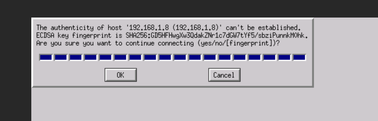

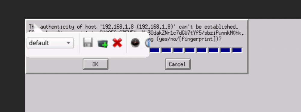

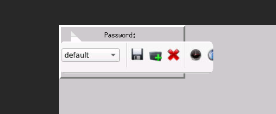

as you see in General support   i have issue with  Lucky Backup  asking  for a Password  or a Yes/No/Fingerprint

i trying to avoid errors like this in Lucky backup.... and the  Yes/no/fingerprint
