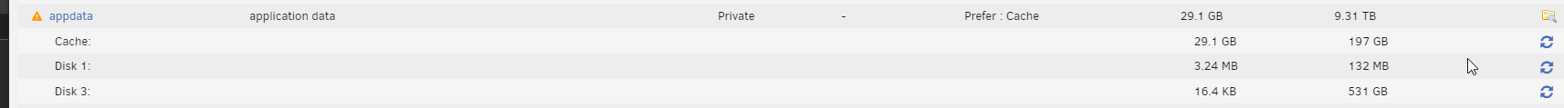

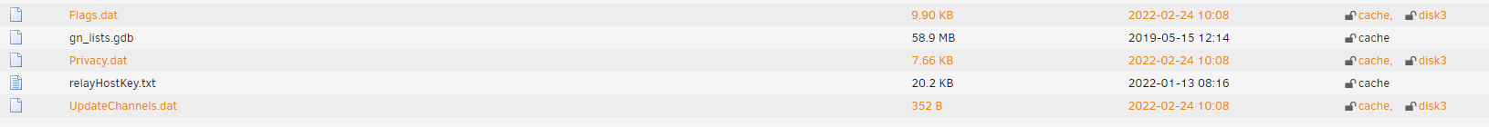

The only thing I can see is when drilling down through the share that some files are marked as "yellow" which I can only presume is some permissions. Could this be preventing them from moving?
Does the disk indicator imply the file is duplicated across both Cache and Disk in the above screenshot?

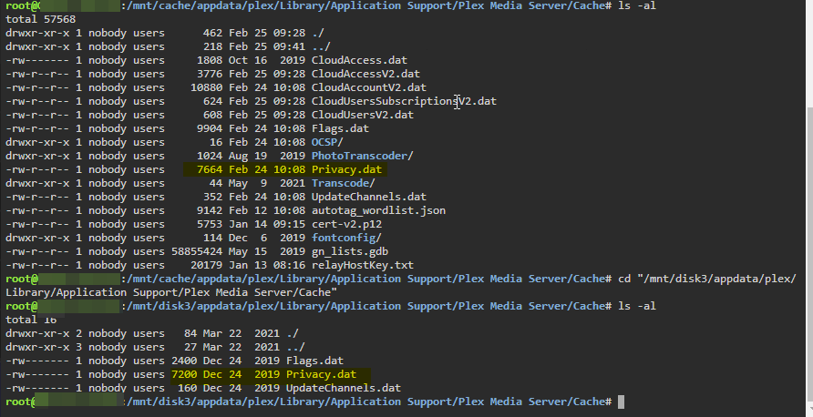

It would seem as though the files on the disks are old.
Perhaps this is why the mover doesn't want to move them?
What course of action would be recommended?
Go in an remove the old files?
Mover won't replace files.
yes
Cool, did a spot check comparing the files in /mnt/disk{n} vs /mnt/cache vs /mnt/user and it seems that the user directory is only looking at cache and whatever is on disk must be old.
Thanks for the advice /response @trurl
/mnt/user includes files on cache and array. User Shares are simply the top level folders on array disks and pools. Files on the lowest numbered disk are shown in the user share if there are multiples. Cache is considered lower than the array. Not really a question of the age of the files but in this case newer seems a reasonable choice to keep.
