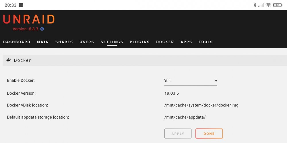

No, as my Plex config folder is located on the NVMe and I use the direct access tweak for the config folder AND the docker.img, everything feels really fast (/mnt/cache instead of /mnt/user):

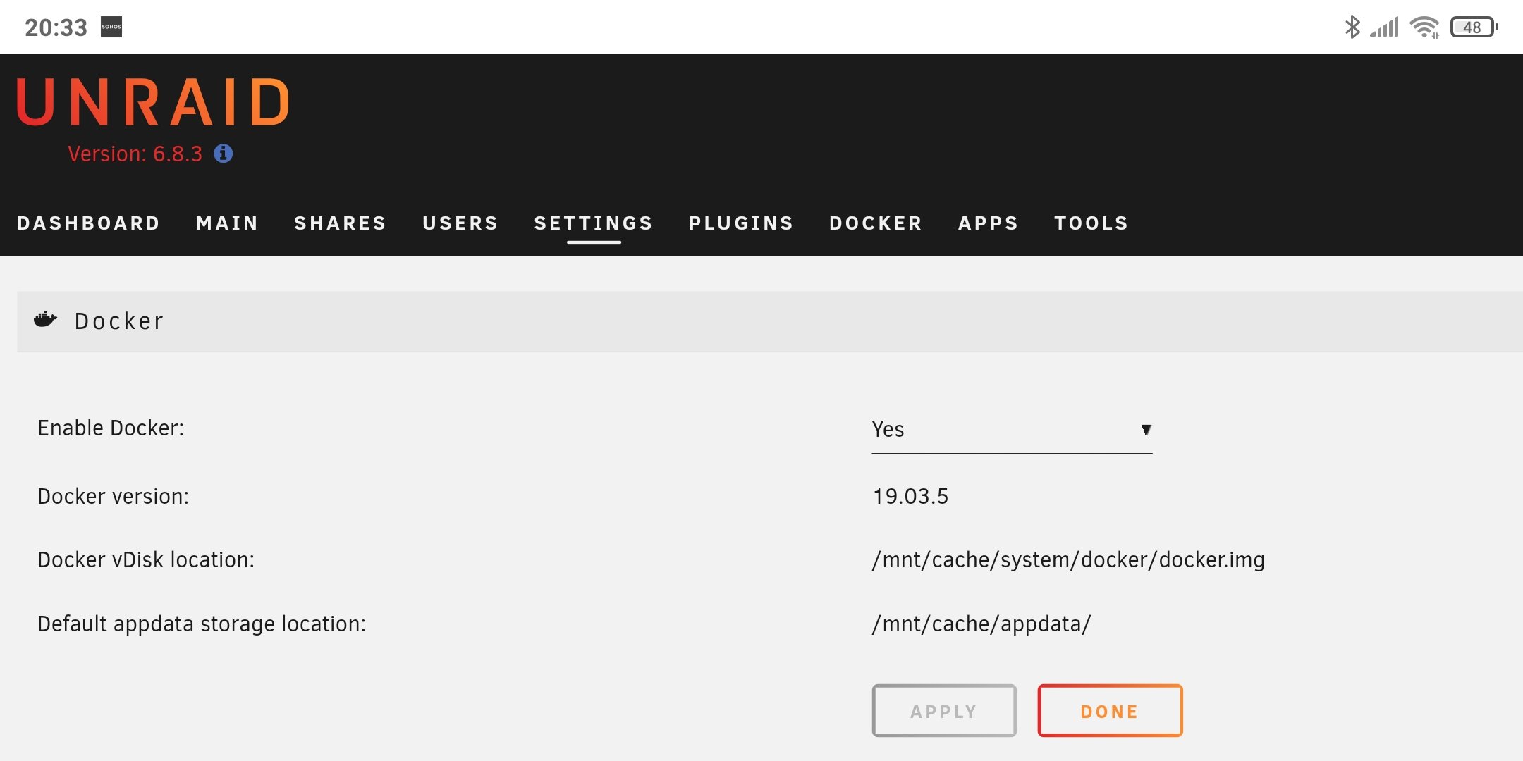

20 hours ago, casperse said:
This could be because I always had everything on the NVme?
Is there any down size of keeping the changes using cache path?
Changing the path of the docker.img influences all reads and writes, that are done inside of this image file. This means all Plex processes like the crawler, transcoder, etc and not the config files like the cover, database, etc. As these processes are relatively small files, the impact isn't great, but even if you save 1% cpu load, why not. The greatest impact comes from changing the appdata path to cache. But this can't be done through the settings as the Plex container is already installed. This means you need to change the appdata path through Docker > Plex > Edit. After this was made, all covers, database reads/writes will be faster. As I described in the tweak, the impact is higher if you have a low power cpu (as a high power cpu can process the Unraid SHFS overhead fast enough). And it will be higher if your cover etc aren't already in the Linux Read Cache. But leave it. It will save you a huge load. Especially if the crawler becomes active. Maybe you like to measure the time to process a full media library scan with and without docker+appdata direct disk access.
The downsize is described in the tweak above: Plex is not able to read/write files outside of the cache drive. This will be a problem if your cache drive becomes full. So with this tweak, it's like setting the "appdata" share to "cache only", even if you change the setting to "no". Plex does not respect this anymore. So if you change the caching to "no" and start the mover, Plex can't start as it does not find the files. But if you move the files back to the SSD or you change the path back to "/mnt/user" it will work like before. So this tweak can be easily reverted without problems.
On 10/1/2020 at 12:54 AM, mgutt said:
I found by accident another tweak:
Direct disk access (Bypass Unraid SHFS)
Usually you set your Plex docker paths as follows:
/mnt/user/Sharename
For example this path for your Movies
/mnt/user/Movies
and this path for your AppData Config Path (which contains the thumbnails, frequently updated database file, etc):
/mnt/user/appdata/Plex-Media-Server
But instead, you should use this path as your Config Path:
/mnt/cache/appdata/Plex-Media-Server
By that you bypass unraid's overhead (SHFS) and write directly to the cache disk.
UPDATE:
This works! - My high memory usage was related to the encoding to RAM and thanks to @mgutt this is not a problem anymore!
Actually I have never seen such speed scrolling through covers like I have now, both for Plex and Emby
(I will make a post about this just to share my experience running both Emby and Plex in this thread soon)
Again! thank you so much @mgutt your tweak really helped me allot - And also the trouble shooting here:
Edited by casperse
