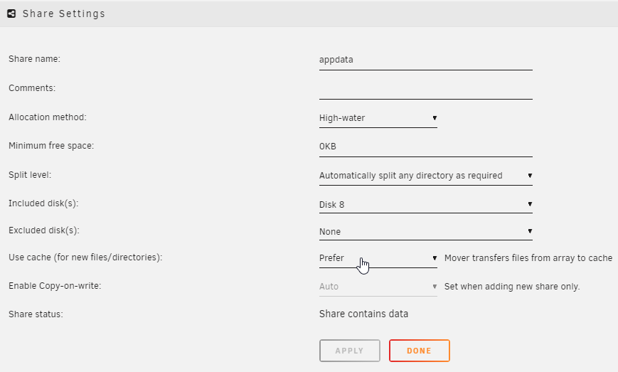

/mnt/cache/appdata/Plex-Media-Server
By that you bypass unraid's overhead (SHFS) and write directly to the cache disk.
Requirements
Of course this works only if you are using an SSD cache and set "Prefer" for your appdata share:
And you must set a minimum free space in your Global Share Settings for your SSD cache:
The reason for this is, that writing directly to the cache disk means bypassing the minimum free space setting and loosing the ability to write additional data to the HDD array. And this causes a positive side-effect: Plex will never write metadata or database updates to your slow HDD array, no matter how full your SSD cache is.
And finally you must be sure that all your Plex Data is located on the SSD and not scattered across SSD and HDD array (check with Unbalance, if you are unsure).

I just tried this with Emby and when the container restarted it was like a fresh install with no data or settings.  I figure no big deal and set it back to /mnt/user/appdata thining all would return to normal but no dice.  Emby acts like it was just installed.  I am reloading a backup but why did this happen?
This can only happen if some files were spread on SSD cache and HDD array, so after changing the path to SSD direct access, emby is not able to find all files (as some are located on an HDD). That's the reason why this is a requirement:
After you started with the direct access path, it created those missing files again like it is done on a fresh install and after you reset the path to Shared Access, Unraid prefers all files, that are located on the SSD, so its still a fresh install. Solution: Move all files from the HDD to the SSD (overwrite all existing files) and now your back on the old status. After that Direct Access will work as well.
Just now, trurl said:
What disk(s) was your appdata on originally?
cache
1 minute ago, RockDawg said:
cache
How do you know?
It's always been set to cache.  But I guess after reading mgutt's reply there must have been some somewhere else.  I'll have to install unbalance and take a look.
cache-prefer can overflow to the array.
You can see how much of each disk each user share is using by going to User Shares and clicking Compute... for the share.
If it ever happens that your cache become full, all new files are written to the HDD array if you've set the appdata caching to "prefer". After that they stay there "forever" as the mover is not allowed to move files that are in use.
Edited by mgutt
So setting it to only will prevent that, right?
I just did that and it's only showing on cache.  Thanks for that tip.  I never knew you could see that info there.  I just assumed it refreshed the total.
Edited by RockDawg
Setting it to only will prevent it overflowing to the array. Instead you would get an error when you filled cache.
But setting it to only won't do anything to get files that are already on the array moved to cache.
I assumed it wouldn't gather any files.  I just meant prevent them from being written anywhere but cache.  But like I said, it isn;t showing anything anywhere over than the cache drive.
Yes and no. If you set it to only and your cache becomes full again, emby will crash (because emby runs out of storage). Thats the reason why I set a minimum free space on my SSD before changing the path to Direct Access as this minimum free space is only valid for Shared Access. By that I have up to 100GB free storage exclusively for Plex no matter how much data is written to the SSD through other processes.
This is strange. One moment, I will test if this feature shows files that exist twice... Hmm no it shows disk8 and cache if the same file is located on both:
