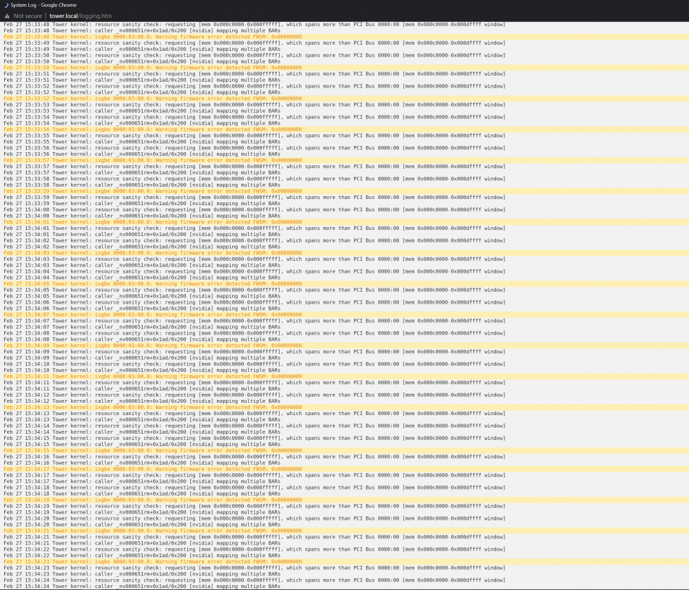

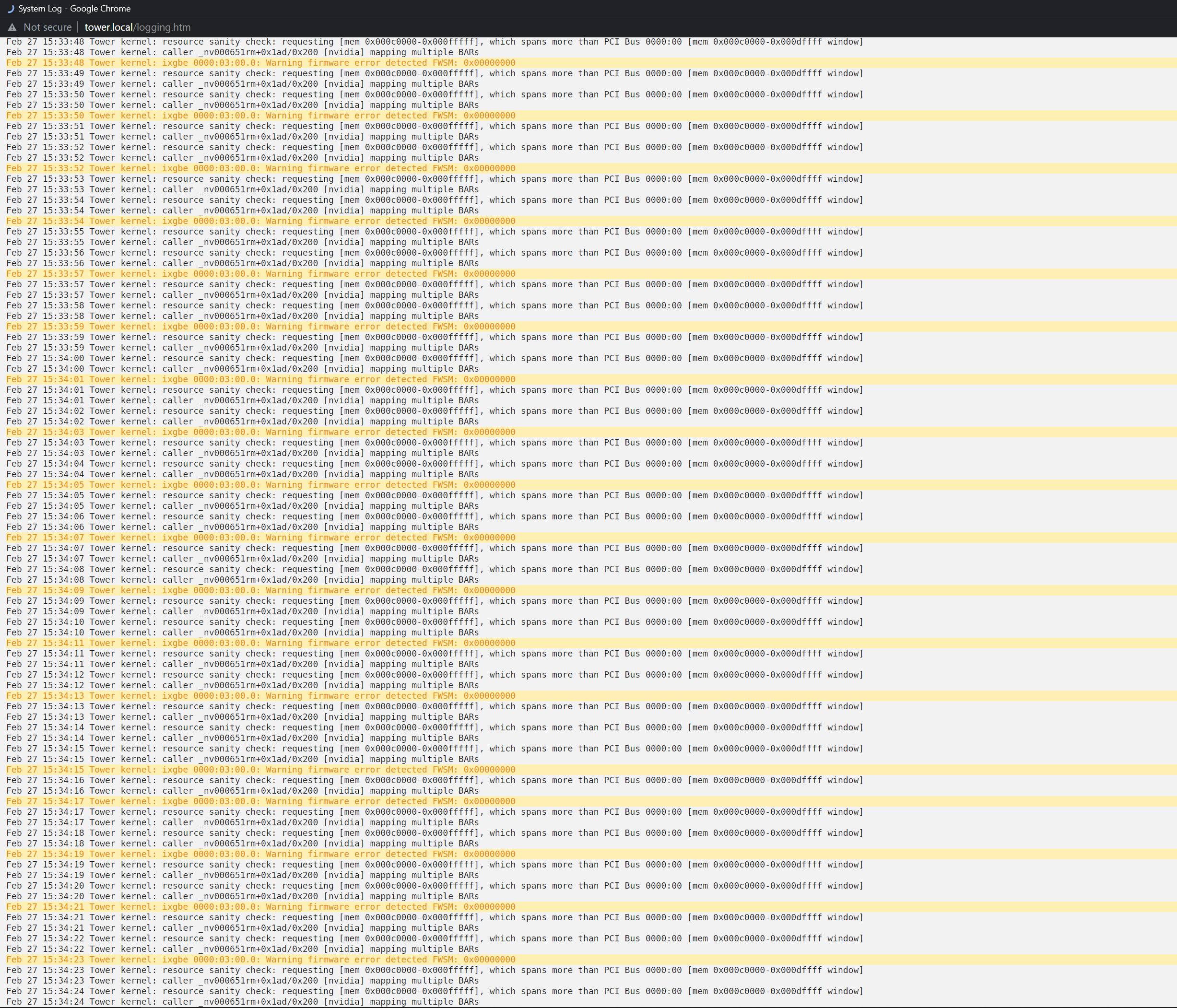

Im new to unraid, and I am having issues with my 10G NIC. It is generating firmware errors in the logs and I am not sure how to fix the issue. The error is:
Feb 27 15:43:01 Tower kernel: ixgbe 0000:03:00.0: Warning firmware error detected FWSM: 0x00000000
ethernet card: Intel E10G42BT X520-T2
MOBO: ASROCK x570 Pro4
CPU: AMD 3900X

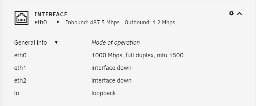

Here is what I am looking at. You have the same issue as mine, your eth1 interface is down. I dont know how to change that to up. I went into the ssh and put in
ifconfig -eth1 up
it didnt give me a error code but if i do a lshw command it states the ports are disabled. if i plug a cable into the disabled prots it spits out a firmware issue in the logs as well.
