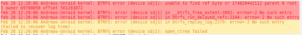

Everything was swimming along nicely until this morning when I updated Fix Common Problems, then went to CA and showed me that docker was disabled. I check things out and see that my cache drive is in read only mode, and one of the 2 SSDs was showing BTRFS errors to trigger this. I was confused why I would have any issues, if one drive had a problem, wouldn't the second be able to keep things afloat?
So I tried stopping the array, this way i can add a spare SSD to pool devices and copy the cache drive contents, then possibly drop BTRFS for XFS and run a single cache drive with scheduled backups. Stopping the array was getting hung up on unmounting the cache drive. i tried manually unmounting, but no joy. So I rebooted into safe mode and now both SSDs are showing as unmountable with no file system.

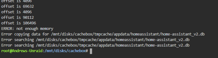

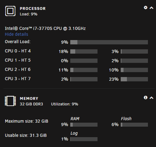

btrfs restore ran for a while but hit a not enough memory error.. not sure what to do next
would re-running skip over what's already restored?

Not sure, you can try, or restore to a different path.
