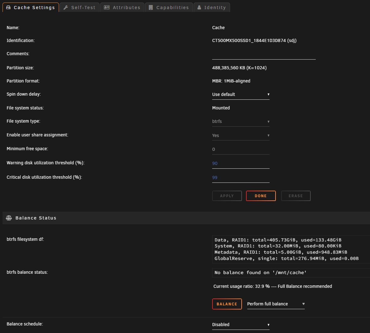

  4. this is the first i'm hearing of memtest86. my motherboard doesn't support ECC ram, so i'm limited to non-ECC. could that be a factor here? to me it just seems the raid1 cache drives were not balanced and just threw a ton of errors without a way for me to rebalance. i wound up swapping the older SSD with the other older SSD and let unraid rebalance, and i've been fine ever since so i guess this wasnt a filesystem corruption. i'm still not 100% sure what happened.

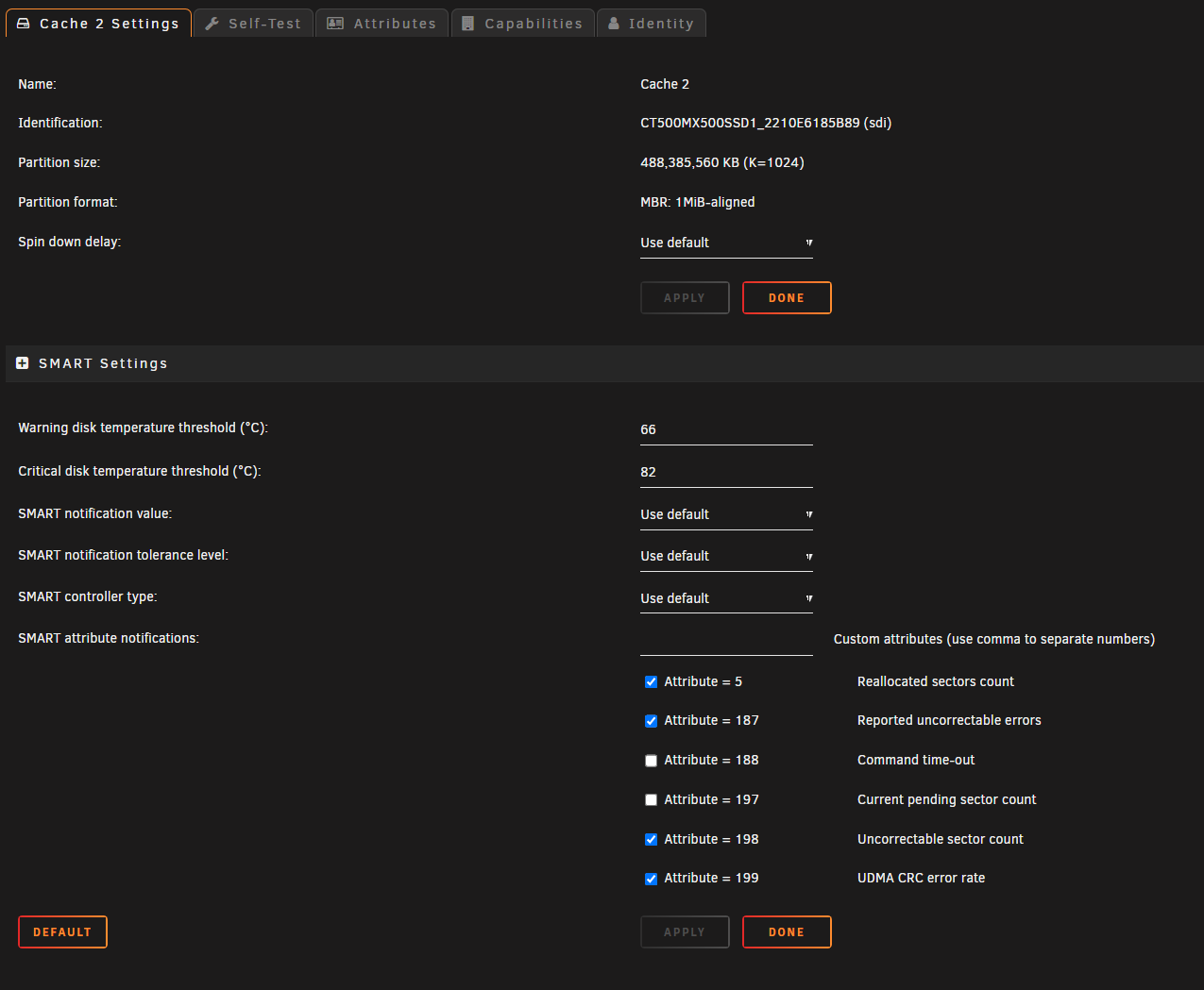

  6. This is now the third time I have to backup, reformat, and restore my cache pool due to BTFRS filesystem issues. Logs attached. Any idea what's causing this? I thought it was a bad cables as I would have ECC error count on the SSDs move from 0 to 1 and back regularly, so I replaced my SATA cables. Then one in particular still kept throwing that error a lot so I bought a new SSD to replace it in the pool, but it's now my understanding that's just some kind of bug with MX500 SSDs and I'm still having this issue. I really like the idea of having SSD drive fault tolerance with a pool, so I really don't want to go to a single drive XFS. Plus my OCD kicks in when I see that exclamation point on the shares tab telling me my cache shares aren't protected. syslog.2

  11. roger that. thanks for your help. i almost had an anxiety attack
  12. for my new cache pool, would it make sense to run a single drive primary cache and schedule rsync on the entire drive to a secondary SSD pool, this way both drives are XFS, both drives have independent filesystems, and i could stop the array and hot swap the backup cache in case of failure. is this plausible or am i missing something?
