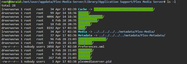

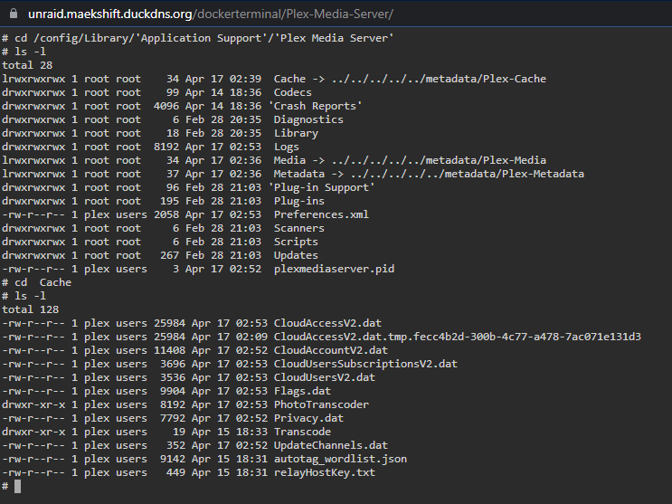

I posted here the other day thinking I got it working with nested folder mappings, but like can0n says, that doesn't work. I deleted my last post since i was completely wrong.

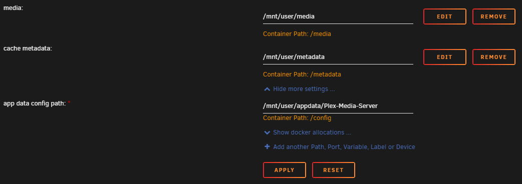

but I'm happy to say that i believe i actually got it working with symbolic links, specifically relative symbolic links, AND i needed to map the path of the symbolic link destination to the docker as well.
so like lotetreemedia said, copy/move the directories, create RELATIVE symbolic links (-rs not -s), and add a new mapped path to the destination. when plex is inside the docker and sees the symbolic link, it tries to follow that path. so a standard symbolic link won't work because the /mnt/user/newshare directory doesnt exist within the context of the docker, you need to also map that share to a location within the docker. maybe you could do a standard symlink too and just map the full host path to be the same in the container path, but whatever i used a relative symlink and just mapped the share to the container's root. i got it to work on all 3 folders, Cache, Media, and Metadata
stop the docker, move the folders, and create the links
cd /mnt/user/appdata/plex/config/Library/'Application Support'/'Plex Media Server'
mv Cache /mnt/user/metadata/Plex-Cache
mv Media /mnt/user/metadata/Plex-Media
mv Metadata /mnt/user/metadata/Plex-Metadata
ln -rs /mnt/user/metadata/Plex-Cache Cache
ln -rs /mnt/user/metadata/Plex-Media Media
ln -rs /mnt/user/metadata/Plex-Metadata Metadata
now your folders are linked like this
then add a mapped path to the new metadata share
and BOOM, bobs your uncle
