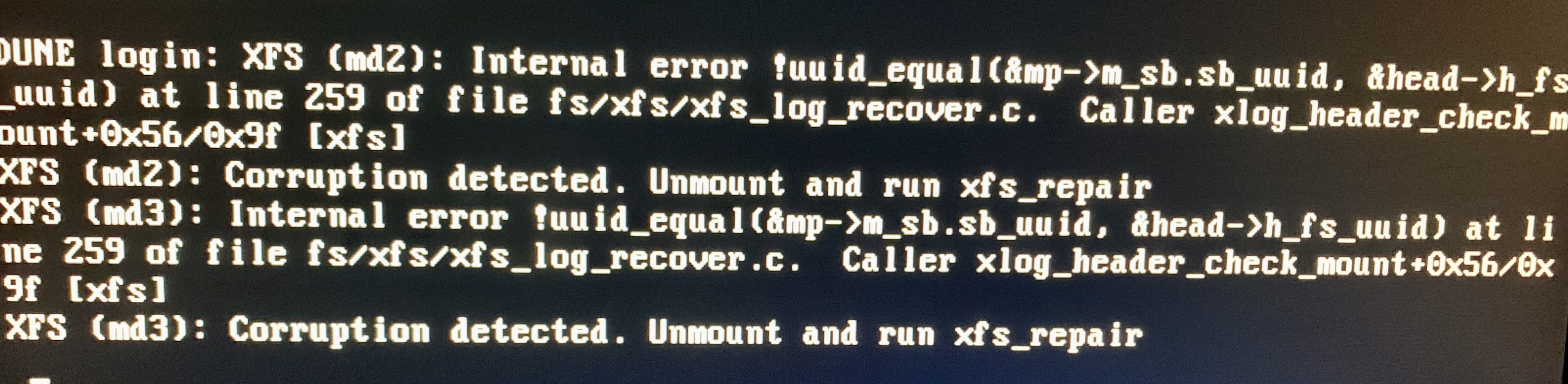

On the monitor connected to the server 2 separate errors
1. XFS (md2): Corruption detected. Unmount and run xfs_repair
2. XFS (md3): Internal error !uuid_equal(&mp->m_sb (see screenshot)

I did the check on both drives and it referred me to run XFS_REPAIR. I ran the terminal command and got the following results for both drives.
SB summary counter sanity check failed
Metadata corruption detected at 0x47518b, xfs_sb block 0x0/0x200
libxfs_bwrite: write verifier failed on xfs_sb bno 0x0/0x200
xfs_repair: Releasing dirty buffer to free list!
xfs_repair: Refusing to write a corrupt buffer to the data device!
xfs_repair: Lost a write to the data device!
fatal error -- File system metadata writeout failed, err=117

What terminal command exactly? Better to run it through the webUI so the command is run correctly.
