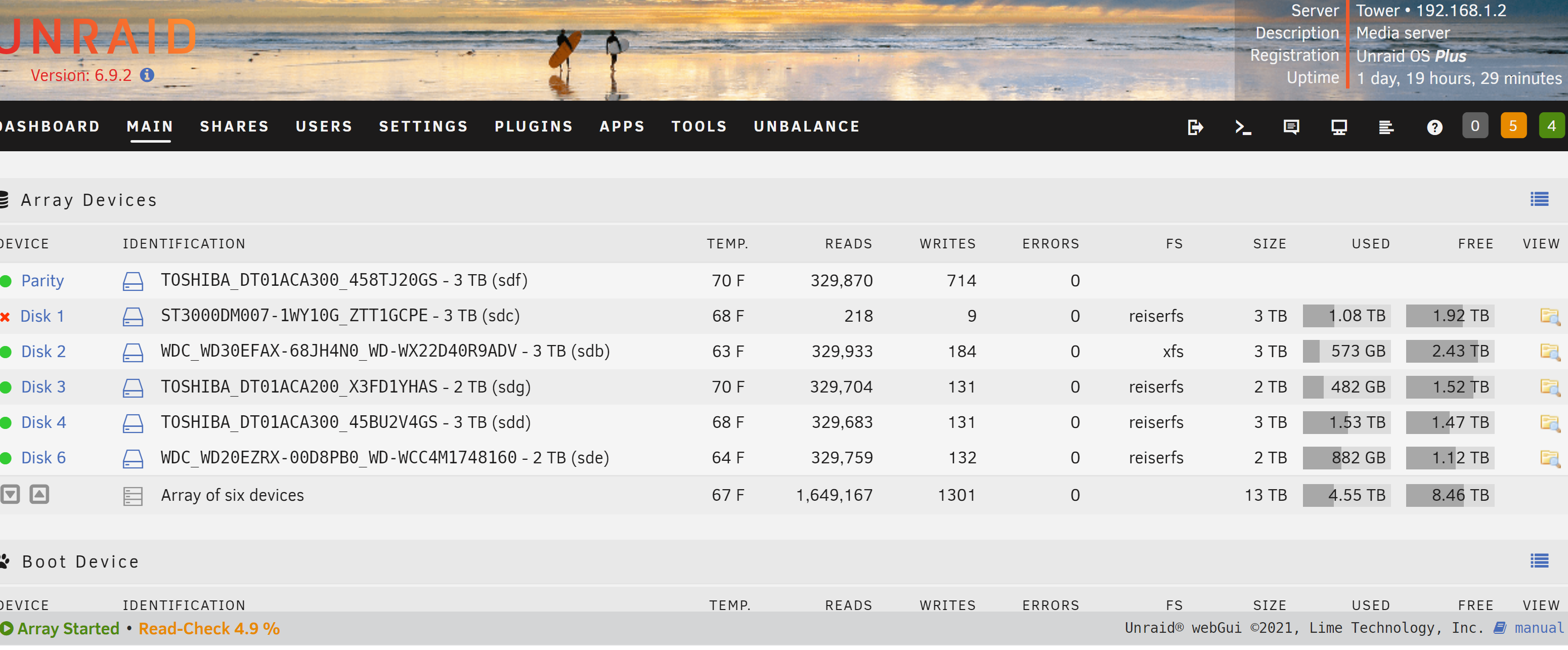

I had drive 1 die. So I bought a new same size, 3TB drive and ran preclear and formatted it as XFS, (I am trying to convert all my drives to XFS). But it still says it is formatted as reiserfs. And them mounted it. Then I chose it to be drive 1. After starting the array, it does not seem to be rebuilding the drive from parity. And the drive has an "x" next to it not the yellow caution icon. What am I doing wrong? Thank you, I am not good at fixing things when they go wrong.

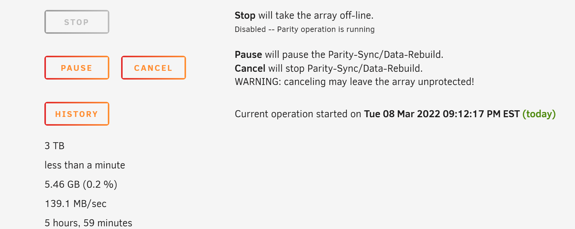

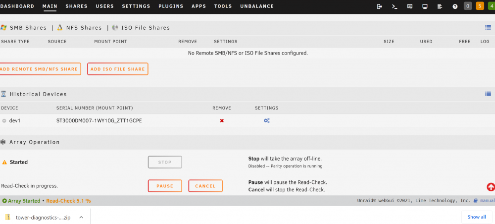

So with that out of the way, apparently you are running a read check of the array instead of rebuilding disk1. Cancel the check, stop the array, change disk1 to none, start the array, stop the array, change disk1 to the correct disk. This should rebuild your reiserfs file system as it's being emulated currently.
