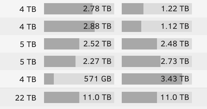

I'm okay tossing out disk4 in my array, disk5 has lots of open space and I have a 4TB drive that just passed pre clear that I plan on throwing back into the array when this fiasco is resolved.
I've also shut down all dockers, and stopped mover and any other auto-run plugins for the time-being as I was getting ready to use unBalance to move all disk4 onto disk5, until the attached message cropped up.
