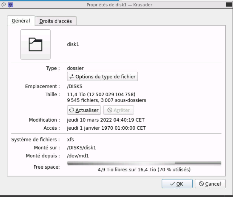

Through my years of Unraid use I've occasionally used manual transfer between disks using Krusader or SMB.
I've been busy with pretty large transfers between drives the last few days as I've been reorganising shares between drives.
However, I seem to have 'lost' free space in the process. Two of my 8TB drives show that they're 99% full but using SMB or Krusader there's only like 80-90% 'real' data on there. My guess is there are hanging bytes or something that Unraid sees as used but which are not really part of a readable file.
How are you coming to that conclusion ?
Some part of the drive capacity will be used by the file system. The more advanced and resilient a FS is, the more metadata it requires. I would guess that some of the capacity is 'used' there.
Also, you should consider that different tools are using different measurement units (GB vs GiB).
Yeah, looks like Krusader uses TiB while Unraid uses proper TB  (Tio is the french for TiB ^^)
Ok merci beaucoup, this seems to be the 'problem'
I have been schooled like a toddler
