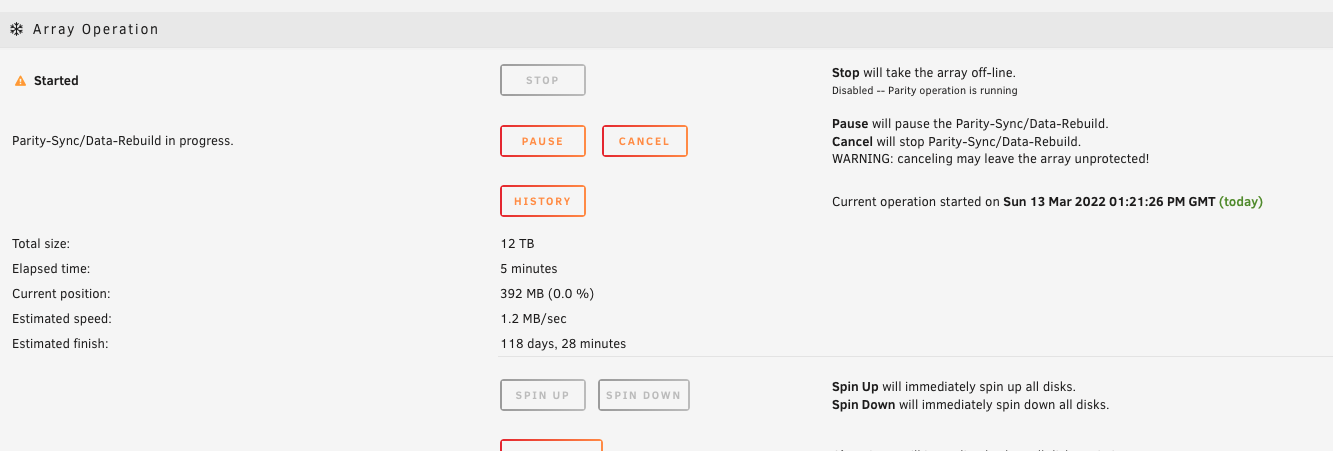

I've recently bought a Dell H200 HBA LSI SAS Card to replace a PCIE SATA controller that died. I decided to take out both my PCIe SATA controllers since with the HBA card I am now able to connect 8 SATA drives using 2 SATA breakout cables. I end up connecting 6 HDDs to the the new card, the rest are directly connected to the motherboard.
I also replaced my Parity disk and am currently trying to replace a dying disk with the old Parity.
I've had some hiccups since putting in the new card. One random disk became unmountable. Had to do run xfs_repair with the -L flag. It is now mountable.
My current problem is that when I start the array and begin rebuilding the disk (the one I am replacing with the old Parity), the rebuilding speed is absurdly low (1.2 MB/s), and the server makes these strange sounds, as if all disks spin up and are being read during 1 second, then all stop at the same time, then they're all read at the same time, and so on repeatedly.
Are HBA SAS Cards power hungry? Is this maybe caused by lack of power? I kept the same PSU and the Parity copy I performed before only spinned two disks (old and new Parity), instead of all 13..
I also installed extra fans this time. So now the system has roughly around 12 HDDs, 7 fans, one HBA SAS LSI card and an i7 4790k.
I've paused the Rebuild just to avoid any damage to the disks.
I've also attached the diagnostics. The incredible JorgeB has also been helping me along the way.
Thank you all for your time and help.

Constant ATA errors on disk9, check/replace/swap cables (power and SATA) and try again.
That really sounds like the PSU voltage is sagging, could be either lack of capacity or too many splitters / faulty splitters / poor connections. I personally attempt to power 4 or fewer drives from each set of wires coming from the PSU.
Also, is the HBA getting good airflow across its heatsink? The designers assume servers will have forced air across all card slots, but most desktop cases rely on the cards to have their own fans if needed.
Definitely a possibility, especially if the noises are coming from multiple drives, if it's just one as logged it could be just a power/connection issue with that one.
The thread can be closed, it was indeed a PSU issue!
Replaced the old no-name brand 750W PSU with a new Corsair RM1000X 1000W one. Each rail is powering about 3-4 HDDs.
Rebuilding ongoing.
