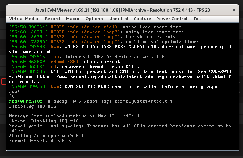

Hi!  My backup server threw a 2TB disk (Enterprise of course, still have 10-year-old WD20EARS in this thing no problem), so I replaced with a 4TB Seagate.  But every time I try to start the array and rebuild the data, it gets to some random point and dies, crashing the server and requiring a hard reboot.  The new drive is fine as far as I can tell, no SMART errors.  Memtest ran for a day with no errors.  I've attached diagnostics from before array start and after the crash, and tails of syslog and the kernel, though it appears nothing is valuable there.  I've also attached a screenshot of the error that finally crashes the server (loudly today with the beeping).  I have searched and found other threads mentioning something similar, but there haven't been any real fixable causes discovered, hope someone out there can help!

Post the output of:
cat /proc/interrupts
SASLP tends to like IRQ16, if it's getting disable during high load it's a problem.

You can try a different slot, but IIRC they tend to always go for IRQ16, best bet would be to replace the controller with an LSI, they are not for a long time recommended for various issues.
  • pengrus changed the title to [SOLVED] [6.9.2] Kernel panic on rebuild
Thanks to @JorgeB for pointing me to the controller.  For those that might have one still chugging away, what looks like is happening is that under load the Marvell-based (AOC-SASLP-MV-8 in this case) controller will freak out over IRQ16 (or 13, sometimes) and crash the server.  The disk being rebuilt wasn't even on the controller, but you need all the disks to participate so...
Anyway, so I went and found a different post (also featuring @JorgeB and @saarg in starring roles) that recommended disabling IOMMU by appending "iommu=pt" to syslinux.cfg.
And now my drive is rebuilt.  I have some more LSIs on order to replace so I can have IOMMU back, but this works for now!
