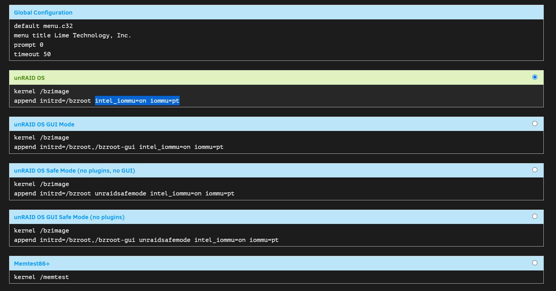

I have a T610; possibly this? But is adding that to boot ARGS a real fix or will it cause me issues later?
