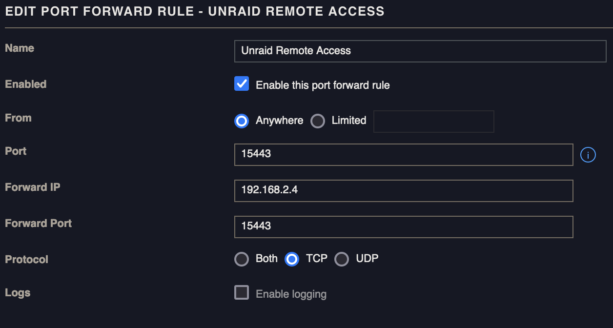

Also here is my port forward
thats an older pic, the forward port is just 5443

So on Settings -> Management Access -> My Servers, if you press the Check button and it says "Unraid is unreachable from outside your network" then pretty much the only thing it can be is an issue with your port forward. One of our servers tried contacting your server at:
  https://[redacted].hash.myunraid.net:[redacted]/robots.txt
but didn't get the expected response.
Update - There is an issue with Remote Access in 6.10.0-rc4 with IPV6 enabled, it will be fixed in the next release. Thanks for including your diagnostics.
