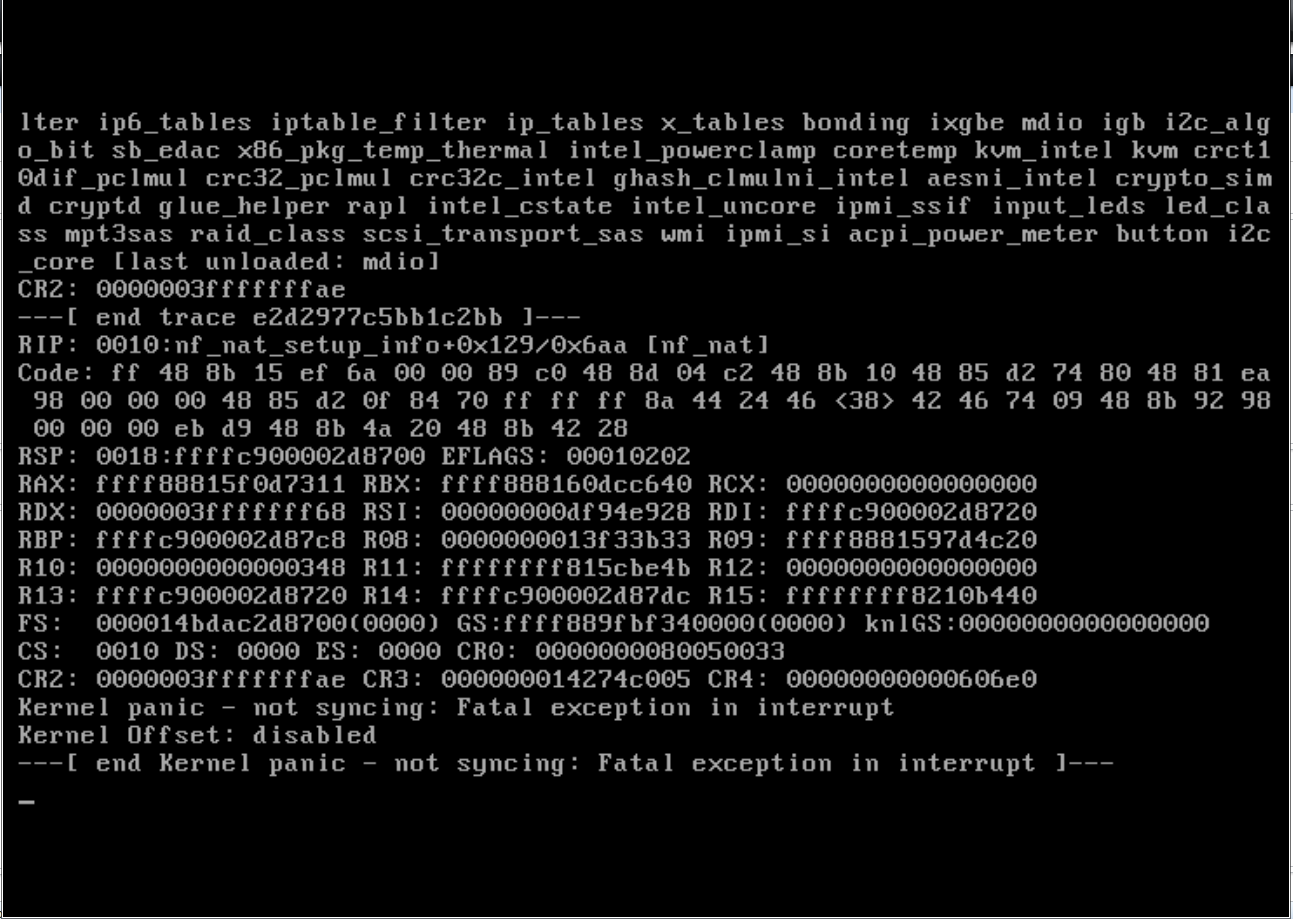

I have Unraid on an R720 that's been rock solid for a long time. Then recently (like 3 or 4 months ago) I've have been getting random kernel panics. Most recently was today. Its always random and I can't recreate it.  I've been super busy with work the last few months to even try to take a look at it. Thank goodness for remote console via the iDRAC.

I see MACVLAN in the log. If you are using docker containers with unique IPs, you should switch to 6.10RC4 and switch your Docker custom network type to IPVLAN that was introduced in 6.10 for that reason.
The setting is in Settings / Docker Settings. You may have to switch to advanced view.
I've updated and set to IPVLAN, lets see if I can more than a week without a crash.
