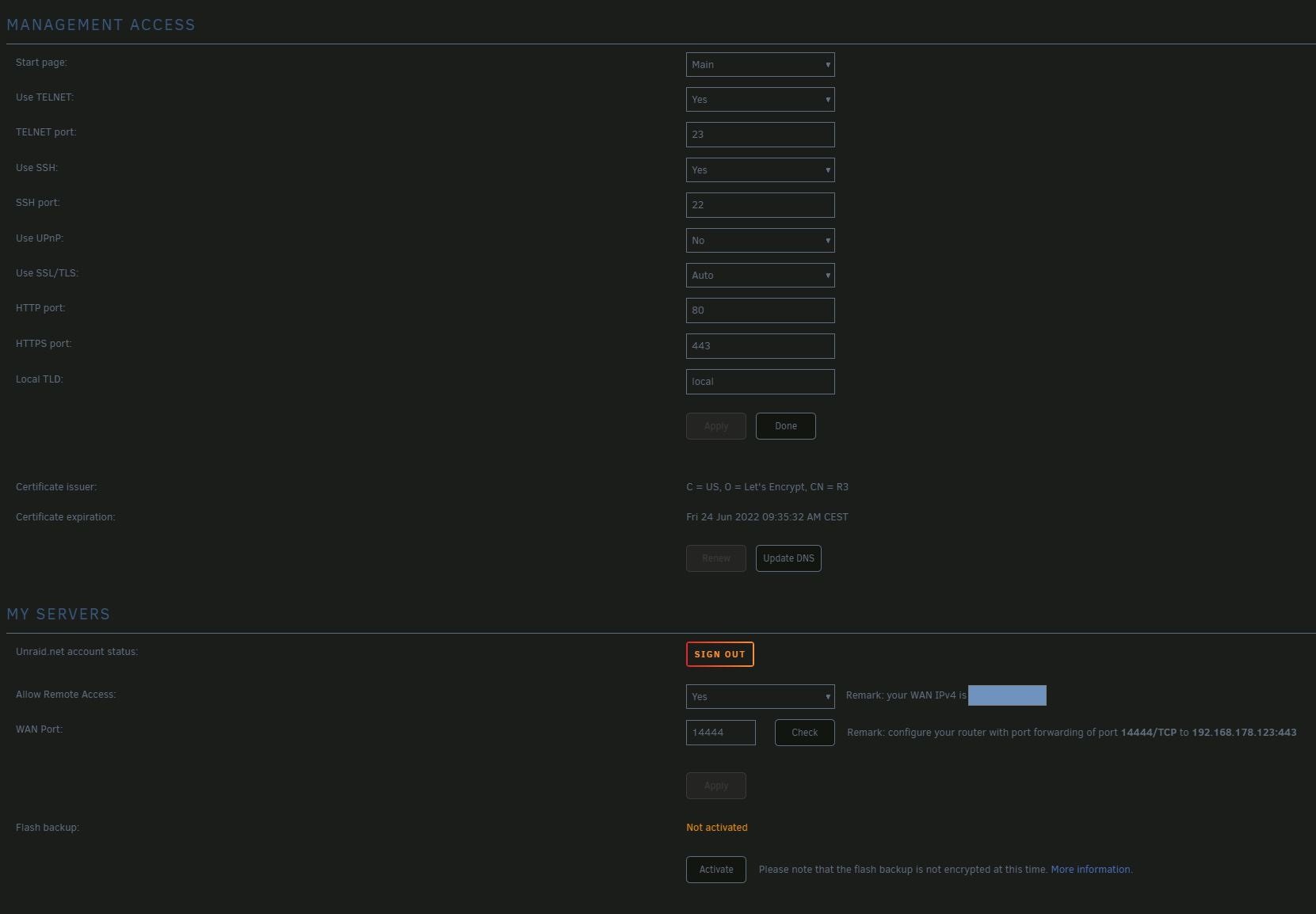

Unable to connect to backup.unraid.net:22
I searched if anyone is facing this problem, I did not find anything.
I followed the Docs and SpaceInvaderOne video to install the plugin.
Even the flash backup does not work and show this message:
Needless to say that the remote access did not work as well, and I did everything according to the Docs, but this is another problem and I will post it later. At the moment, I want to solve at least the flash backup.
Settings:
This means there is a firewall on your network preventing your Unraid system from making an outgoing SSH connection to backup.unraid.net on ports 22 or 443.

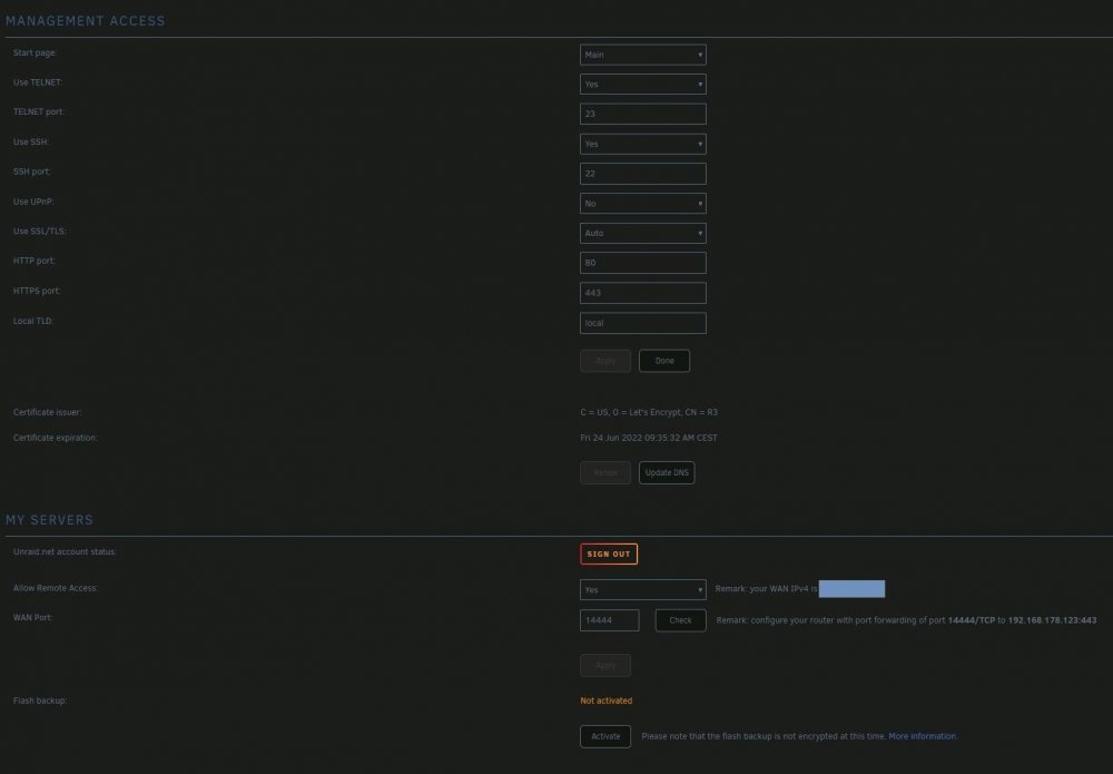

Settings:
Have you tried the following from terminal on the Unraid server
ssh backup.unraid.net
if port 22 is open, you should get a permission denied if port 22 is open.
Have you checked your DNS rebinding options on your router?
I had similar issue, and resolved it following the instructions under the "?" at the top right, and following the instructions  in the last "blue" help box.
