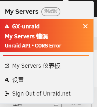

How to solve this error in MY SERVER plugin?
1 minute ago, ljm42 said:
Are you using a reverse proxy?
I I used ddns to bind the domain name to my ip and set up port forwarding in the router background, is this a proxy?

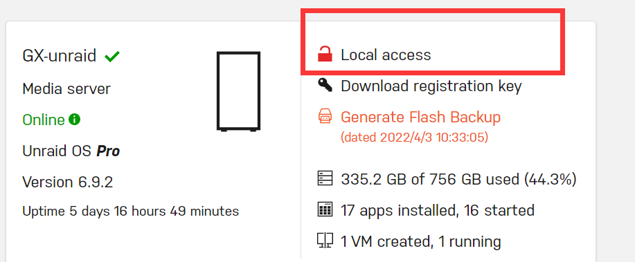

Thank you for your recovery, I have another question, what should I do if the local access is unavailable?
Please upload your diagnostics (from Tools -> Diagnostics)
The server's name is set on the Settings -> Identification page, yours is "GX-unraid"
The server's Local TLD is set on the Settings -> Management Access page, yours is blank
So the server's url is http://gx-unraid/, I assume that is what the "Local Access" url points to?
If you want the server's url to be http://myserver.mydomain.com/ , then you would first setup DDNS so that myserver.mydomain.com resolves to your server's IP address. Then set your server name to "myserver" and the Local TLD to "mydomain.com"
Does that help?
Does that help?
thanks, i'll try it.
