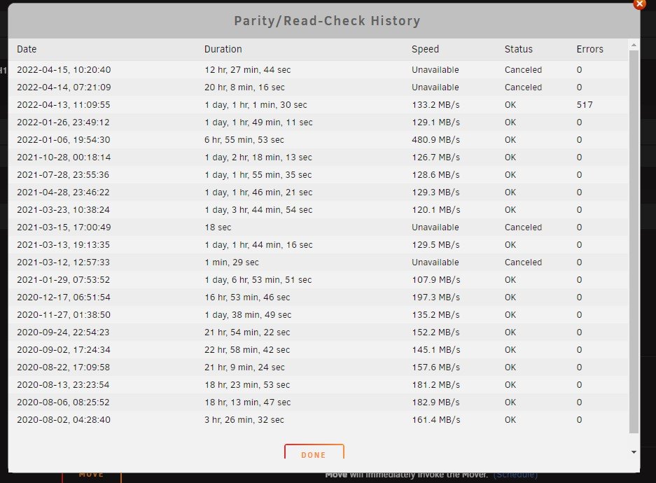

I was doing an uncorrecting parity check to verify that my correcting parity check fixed the sync errors.

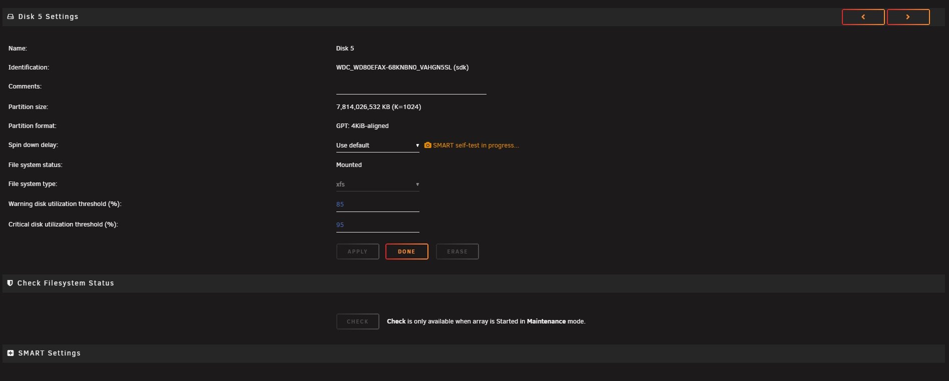

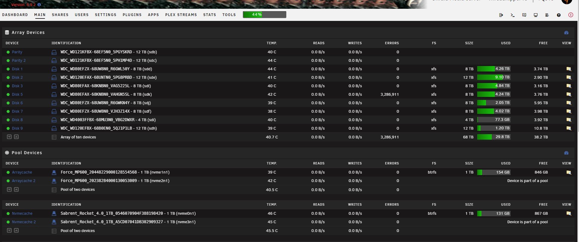

I woke up today to find that my network connection to my server dropped. I logged in locally and there were a ton of warning popups.

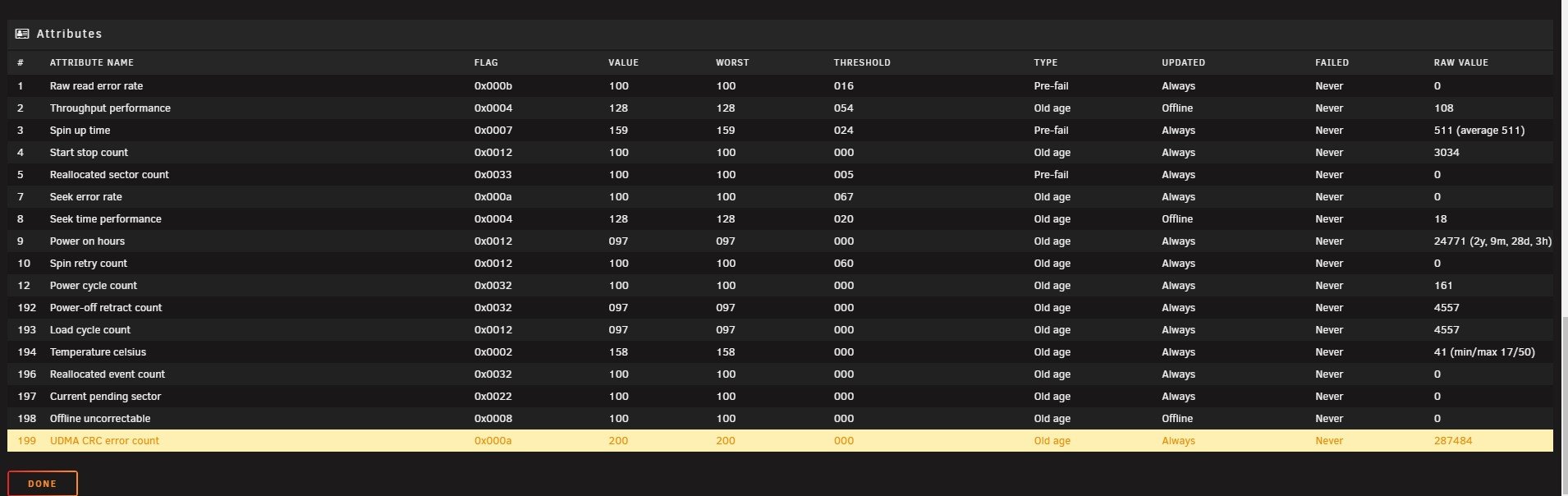

Now I have yet another disk that received UDMA CRC errors and is showing Errors on the main tab.
The errors just kept coming, so I stopped the parity check.

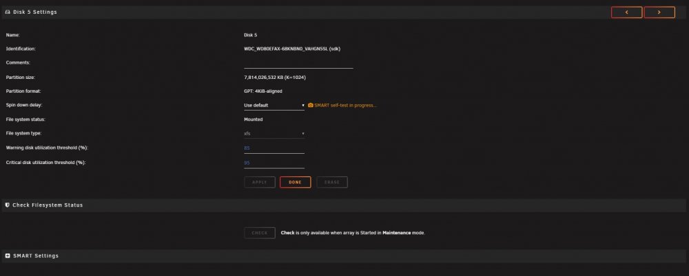

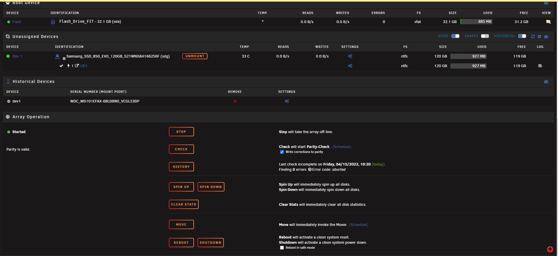

I grabbed all this information before I shutdown the server, because I don't want it running at this point.

3 minutes ago, FQs19 said:
Are we positive that it's not the LSI card?
It can be, it could even be neither, it could be for example a PSU problem, but since there are also CRC errors and those can basically only be from the controller, cables or backplane and the other disk issues are likely related it should be one of them, backplane more likely but HBA is also a possibility, especially if it's a Chinese fake, unfortunately no way of knowing for sure until you rule one of them out, either by using a different HBA or connecting the disks directly bypassing the backplane (or using a different one).
Thanks for responding to all of my problems. I really appreciate it.
So moving my server into the new case without the backplane should be my first step?
It's what I would do, unless you have another HBA you can try with.
