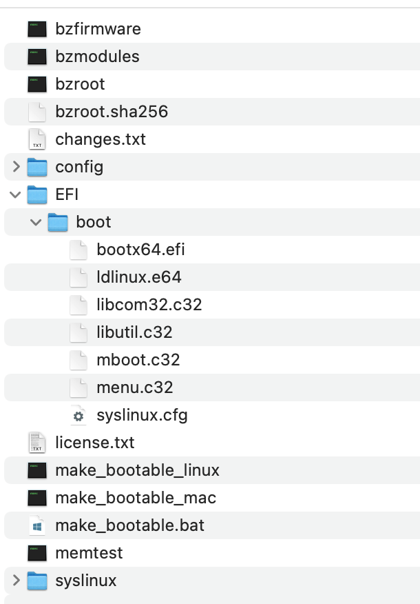

If it makes a difference, I created the USB manually and used the make_bootable_mac script. I went through a whole draw full of USB flashdrives, none were recognisable by the unraid flash creator :(
If you need UEFI you need to rename directory EFI- TO EFI
It is:
1539446732_Screenshot2022-04-28at23_09_41.thumb.png.0f6645b576d51de9c8a95bd5d0015b7e.png
Ok, re-downloaded and flashed, now boots fine. But I can't access the web interface. Everything I've read seems to suggest it should respond on port 80, but nothing.
