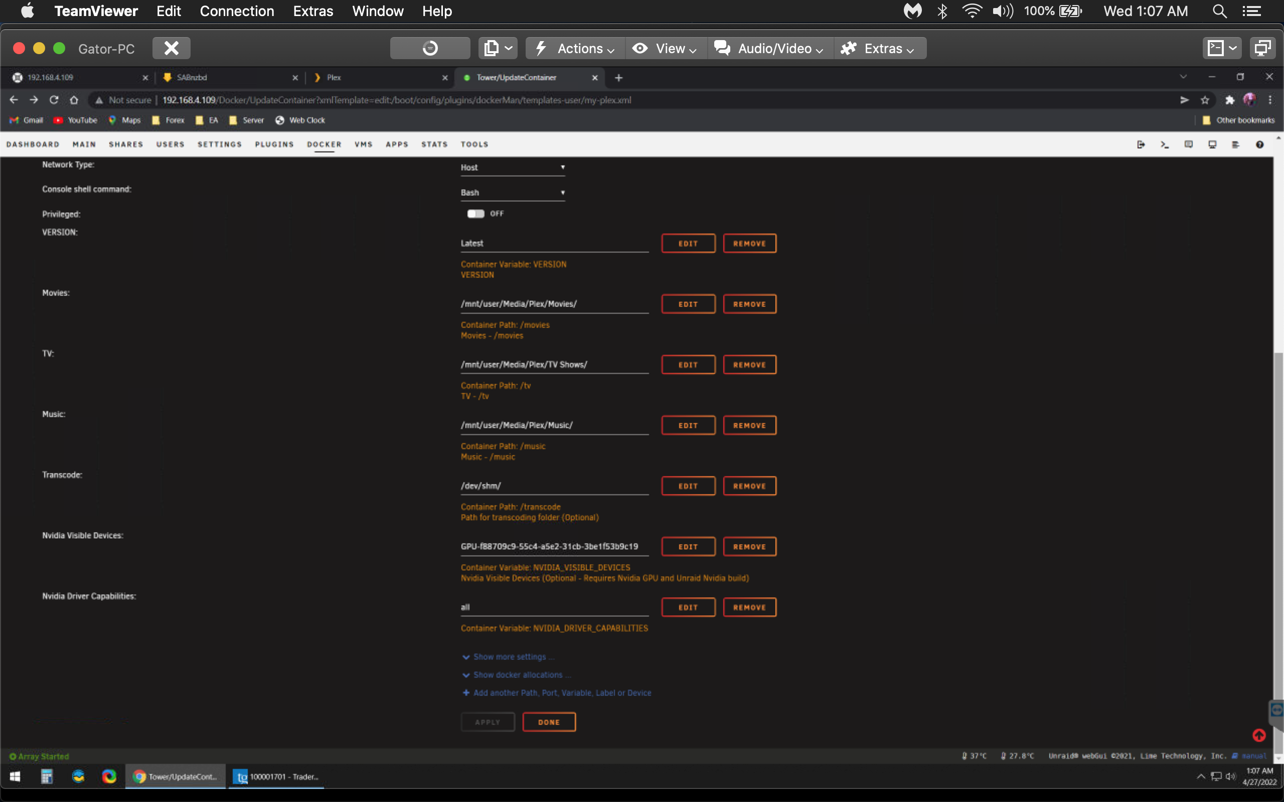

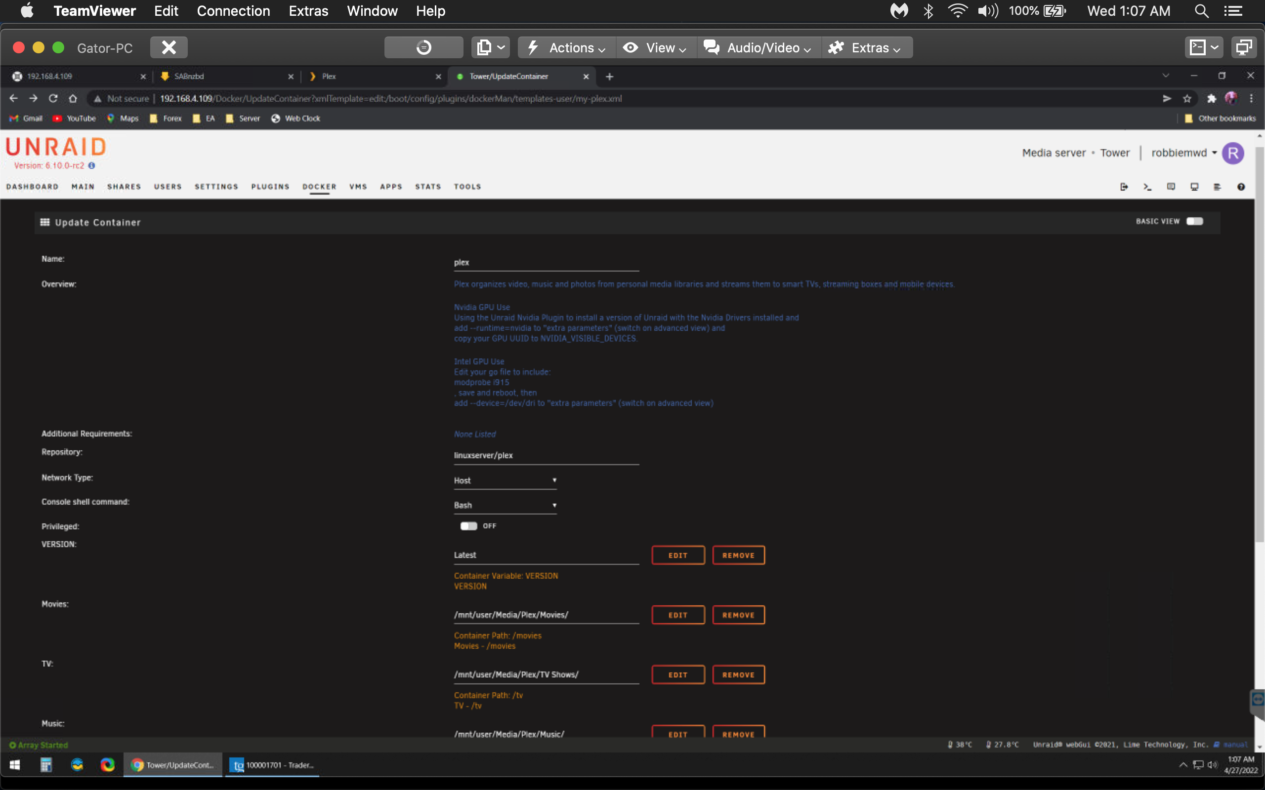

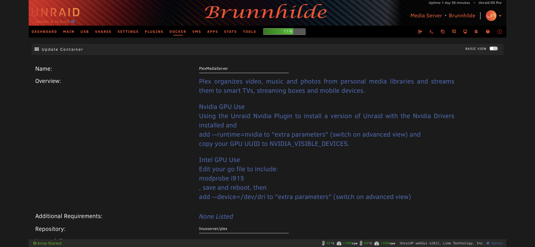

I have been running plex on may unraid server for a couple years now. I rebooted the server the other day and plex gave an error "bad ?" I cannot rememberer what it said exactly... Then it removed the plex docker. I went to add the linuxserver plex docker that I was using and it is missing some of the places where I added the gpu and looks different. I looked at the other plex dockers and I don't see where any of them have to add the gpu. I've tried to add container and add the template for the previous config and I get this...
Pulling image: lscr.io/linuxserver/plex:latest IMAGE ID [788189224]: Pulling from linuxserver/plex. Status: Image is up to date for lscr.io/linuxserver/plex:latest
TOTAL DATA PULLED: 0 B
Command: root@localhost:# /usr/local/emhttp/plugins/dynamix.docker.manager/scripts/docker run -d --name='plex' --net='host' -e TZ="America/Chicago" -e HOST_OS="Unraid" -e HOST_HOSTNAME="Tower" -e HOST_CONTAINERNAME="plex" -e 'VERSION'='Latest' -e 'NVIDIA_VISIBLE_DEVICES'='GPU-f88709c9-55c4-a5e2-31cb-3be1f53b9c19' -e 'NVIDIA_DRIVER_CAPABILITIES'='all' -e 'TCP_PORT_32400'='32400' -e 'TCP_PORT_3005'='3005' -e 'TCP_PORT_8324'='8324' -e 'TCP_PORT_32469'='32469' -e 'UDP_PORT_1900'='1900' -e 'UDP_PORT_32410'='32410' -e 'UDP_PORT_32412'='32412' -e 'UDP_PORT_32413'='32413' -e 'UDP_PORT_32414'='32414' -e 'PUID'='99' -e 'PGID'='100' -l net.unraid.docker.managed=dockerman -l net.unraid.docker.webui='http://[IP]:[PORT:32400]/web' -l net.unraid.docker.icon='https://raw.githubusercontent.com/linuxserver/docker-templates/master/linuxserver.io/img/plex-icon.png' -v '/mnt/user/Media/Plex/Movies/':'/movies':'rw' -v '/mnt/user/Media/Plex/TV Shows/':'/tv':'rw' -v '/mnt/user/Media/Plex/Music/':'/music':'rw' -v '/dev/shm/':'/transcode':'rw' -v '/mnt/cache/appdata/PlexMediaServer/':'/config':'rw' --runtime=nvidia --mount type=tmpfs,destination=/tmp,tmpfs-size=3000000000 --no-healthcheck 'lscr.io/linuxserver/plex' docker: Error response from daemon: Unknown runtime specified nvidia. See 'docker run --help'.
The command failed."
Any help would be greatly appreciated.

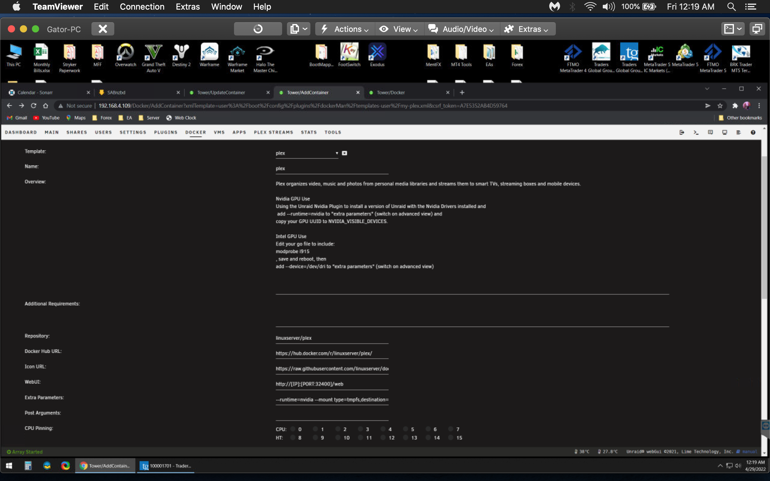

At the top of the docker configuration you should see this-
As it says, for nvidia GPU switch to advanced view and add the proper command in the extra parameters. Looks to me like that is what the error you posted is complaining about. Also, don’t forget to add the UUID.
