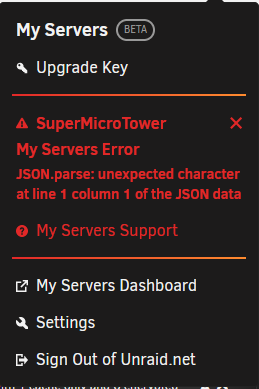

json parse unexpected error
 Not sure what steps to take. This is the only error I don't see here.
 json parse unexpected character at line 1 column 1 of the json data
Solved by ljm42
What version of Unraid are you running ?
What version of the plugin ?
Your diagnostics would provide this information and maybe other information for the team.
What url are you using to access the server?
Based on your settings, it should either be:
  http://SuperMicroTower.local
  or https://ip.hash.myunraid.net
If you are using a different url the API will have CORS errors
Also, there is an issue with this DNS server:
DNS_SERVER1="192.168.3.1"
I'm seeing multiple errors:
ERROR: When using DNS server 192.168.3.1, the host 192-168-3-252.hash.myunraid.net does not resolve.
May  5 13:54:24 SuperMicroTower root: ⚠️ Warning: Your DNS server (192.168.3.1) is unable to resolve 'registration.unraid.net'
May  5 13:54:38 SuperMicroTower root: ⚠️ Warning: Your DNS server (192.168.3.1) is unable to resolve 'mothership.unraid.net'
May  5 13:54:52 SuperMicroTower root: ⚠️ Warning: Your DNS server (192.168.3.1) is unable to resolve 'wanip4.unraid.net'
May  5 13:55:06 SuperMicroTower root: ⚠️ Warning: Your DNS server (192.168.3.1) is unable to resolve 'backup.unraid.net'
Also, the syslog shows some network issues:
May  5 14:05:25 SuperMicroTower root: Fix Common Problems: Error: Unable to communicate with GitHub.com
May  5 14:05:25 SuperMicroTower root: Fix Common Problems: Other Warning: Could not check for blacklisted plugins
May  5 14:05:26 SuperMicroTower root: Fix Common Problems: Other Warning: Could not perform unknown plugins installed checks
This may be due to the DNS Server issue above, or it may be because of this:
May  5 14:05:26 SuperMicroTower root: Fix Common Problems: Error: Multiple NICs on the same IPv4 network ** Ignored
which is described here: https://forums.unraid.net/topic/120220-fix-common-problems-more-information/page/2/?tab=comments#comment-1100014
Thank you, I fixed those issues and now it connects.
