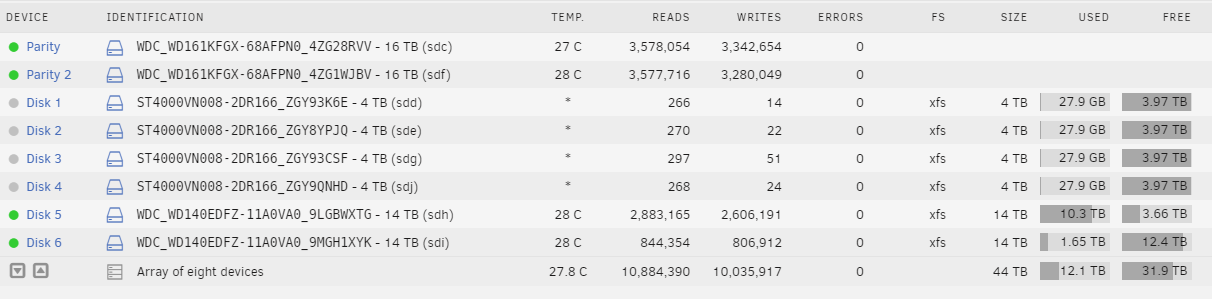

Firstly, my disks. My array has two 14TB drives and four 4TB ones (and two 16TB partidy drives). As I am starting with my server, all data is still being stored in the 14TB ones. As 4TB disks wont be used for a time, I spinned them down.
Regarding the shares, I have created only two. One is small, 183GB, and the other is a big one that I am currently filling with rclone sync and right now takes 11.6TB (all has sense looking at the drives).
I have been waiting some days monitoring the disk allocation and according to picture above, I would say that the high water mark is not working at all. High water mark should be marked by the half of the biggest drive, which is 7TB. Therefore disk 5 should be left at around 7TB and sync moved to disk 6. This is happening sporadically, as you can see some data has been copied, but anyway most of it is allocated in disk 5.

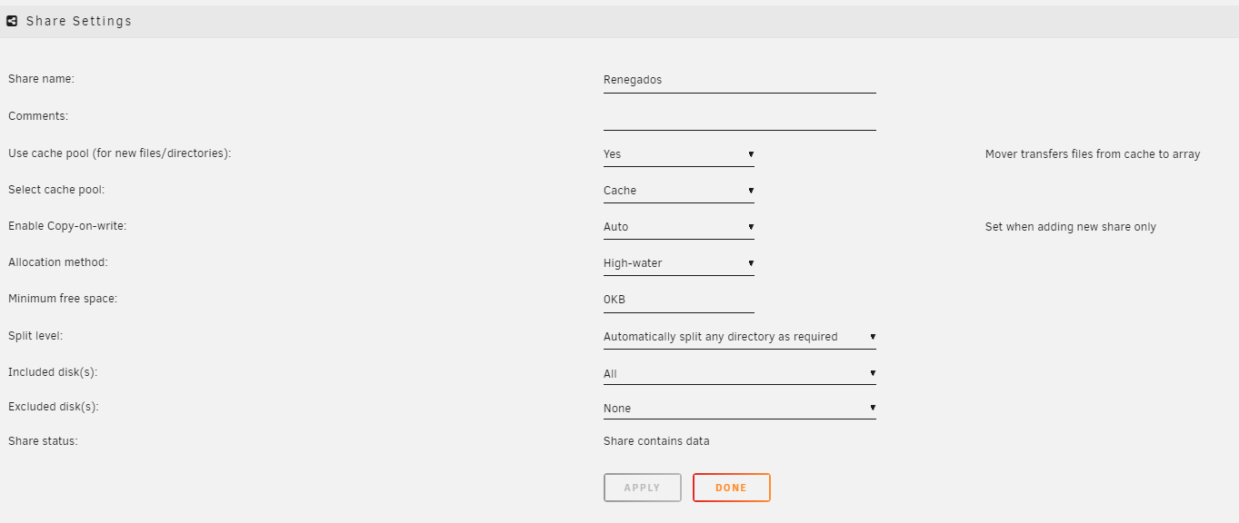

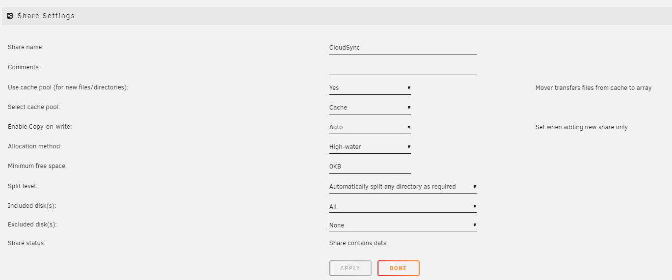

- Both shares have high-water allocation method, automatically split any directory and all included disks / none excluded (pics below)

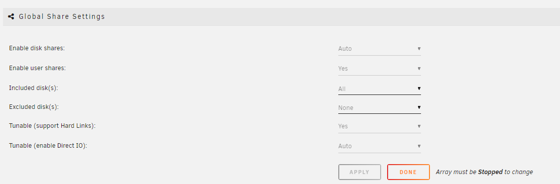

- In global share settings, also all disks included / none excluded (pic below)

This is becoming very interesting...
Situation is the same, but now my disk5 is at 93% full, and the disk6 only 19%. Some data has been written there, but not much.
