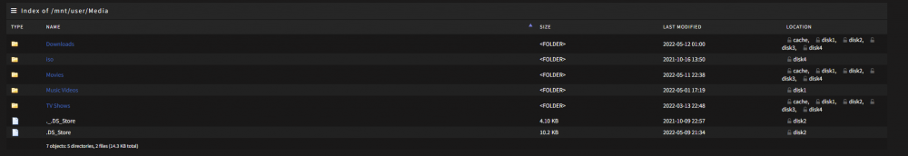

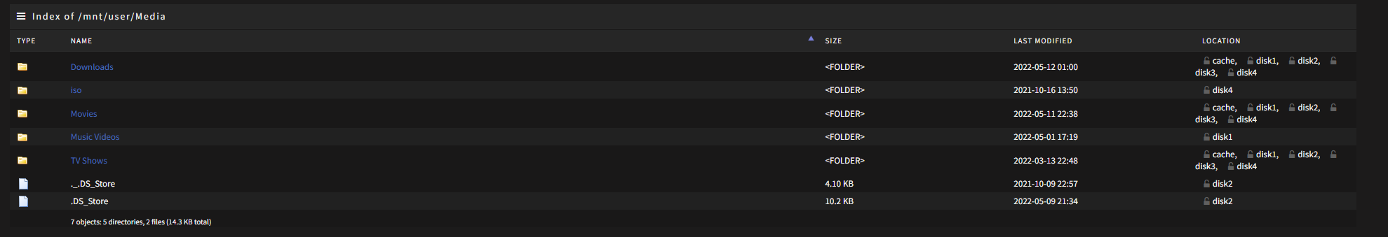

Im noticed I was using a lot of disk space for the amount of media that I have. 95% of my content is 1080p. I have to manually delete my files from my downloads folder, if not I have duplicate files on my server. I dont know which one is the issue either Sonarr or Mover, After sonar moves the files to either Movies or TV Shows without issue. I have the original file sitting in downloads and a duplicate sitting in either respected folders.
When I had sonarr installed on W10 it would simple grab the file from one folder and move it without creating a duplicate file. I dont know what setting I missed while installing the docker but I cant seem to figure out why it does this.

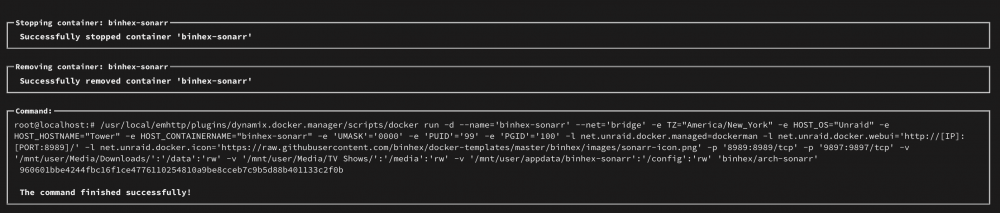

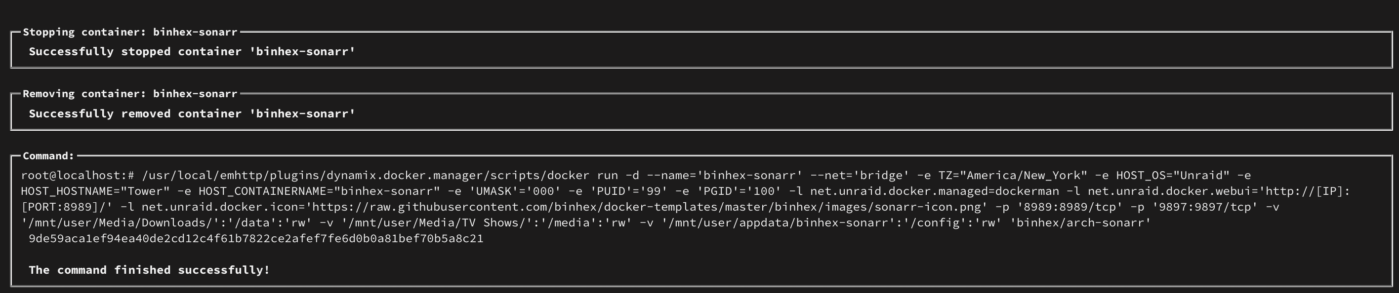

post docker run
can you please clarify. I dont know what docker run is or how to obtain it.
2 minutes ago, JonathanM said:
Click the words docker run.

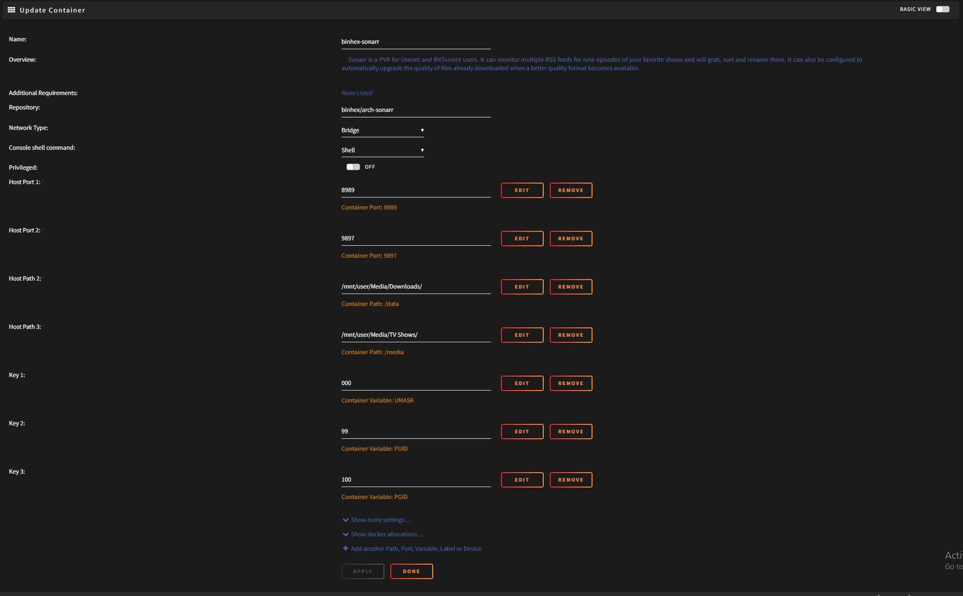

I did click on the hyperlink, problem is from what I under the docker run command prompts when installing or editing a docker image. I dont want to edit the docker to risk making more of a mess.
Is there an other way to get that command prompt without installing or editing the image?
From that linked post:
On 5/26/2017 at 11:03 AM, Squid said:
post the docker "run" command that will appear when you install / edit the application (you can always make any change and then change it back and hit "Apply" to get the docker run command to appear
The change you make doesn't have to be applied, it just needs to be made then changed back to enable the Apply button.

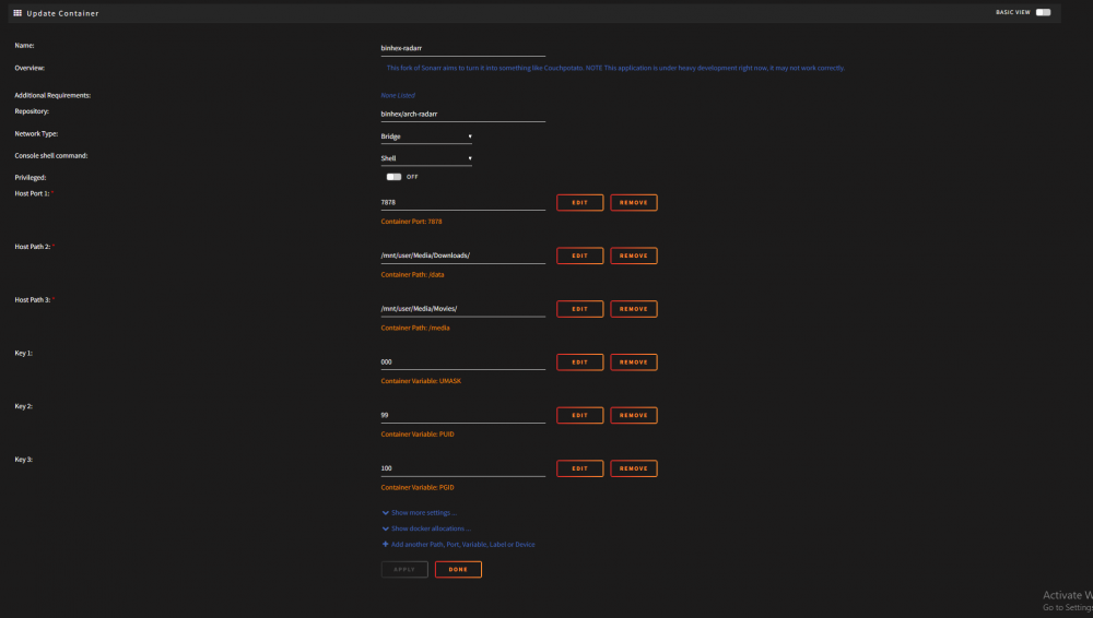

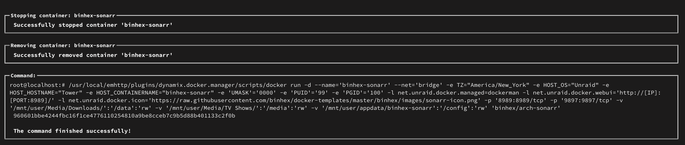

I believe I posted the command run above. Is that what we are looking for or is it something else? I’m a noob to unraid.

Yes, just explaining that you didn't need to apply that first change.
Nothing obvious, but I use a different sonarr container.
Is there anything in sonarr logs that might indicate it tried but failed to delete the download after it had been copied to the destination?

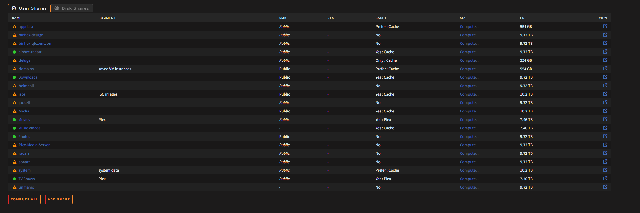

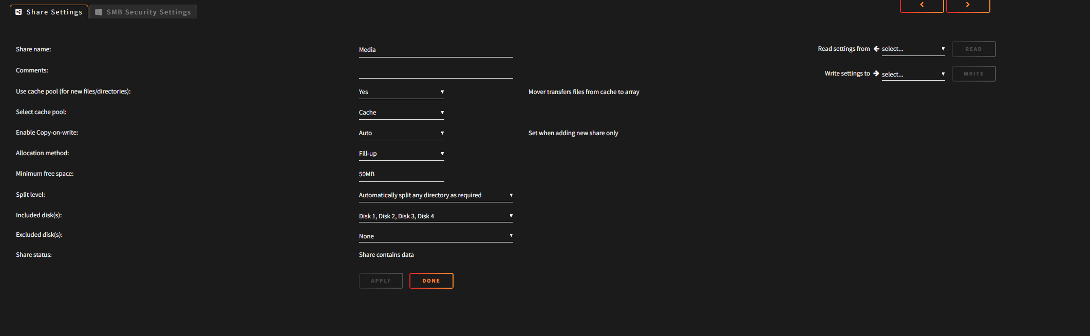

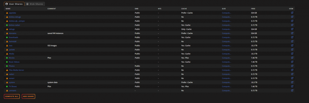

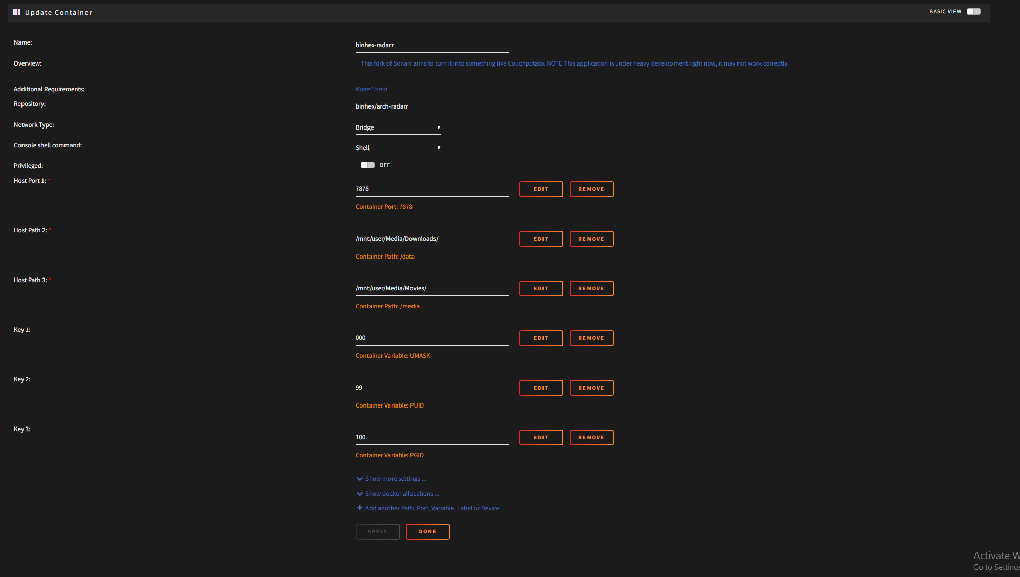

When i had sonnar installed on my windows machine before going to unraid i didnt have the issue. Could it be that my share isnt set up correctly?
