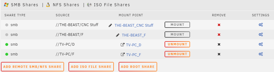

Thanks again Frank. After reboot, I'm able to access via the web gui, but not Windows Explorer. 2 of the shares I had previously setup are offline (see attached screenshot). What do I need to do to mount those again? Do they need to be removed and recreated or something else?
That screenshot is about giving Unraid access to shares on other systems on your network.
Your OP seemed to be about accessing Unraid shares from other systems on your network.
Most of my issues are resolved. The shares were no longer needed anyway so I cut my losses and removed them. And although TOWER doesn't appear under Network, if I type \\TOWER I get in just fine. Not sure what happened that's preventing me from seeing the drive but at least I can get what I need. Thanks all.
