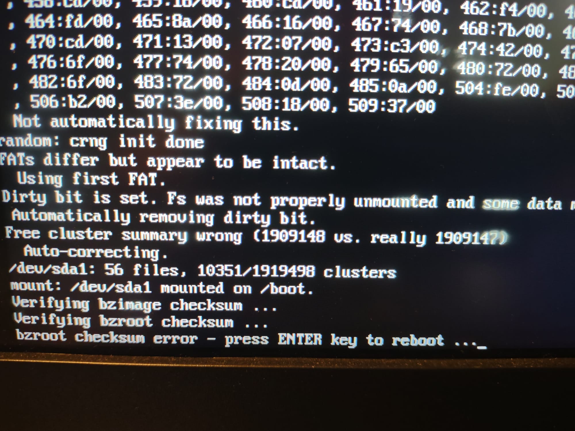

mrbilky Posted May 15, 2022 Share Posted May 15, 2022 Any takers I format the thumb drive use the usb creator tool everything boots up fine on the first boot but if I reboot I get a bzroot checksum error this is on a Dell poweredge R710 it is a backup server and only turned on every now and again to backup my primary this has occured on to different licenses that I have is this a memory issue? I have made no changes in the bios that would suggest I was the cause Quote Link to comment

amixnux Posted January 27, 2023 Share Posted January 27, 2023 Hello, I just changed my mainboard and this problem started to appear. I enabled the virtualization, set up the pendrive from scratch and try with the parameters that for other people worked. Still getting stuck here. Any suggestions? Quote Link to comment
JorgeB Posted January 27, 2023 Share Posted January 27, 2023 Run memtest to make sure it's not a RAM problem, if no errors are detected try a different flash drive. Quote Link to comment
amixnux Posted January 28, 2023 Share Posted January 28, 2023 Thanks Jorge, it was not possible to run it. After updating the firmware from the Bios it started to work, so the memtest was a good place to start looking at 1 Quote Link to comment
