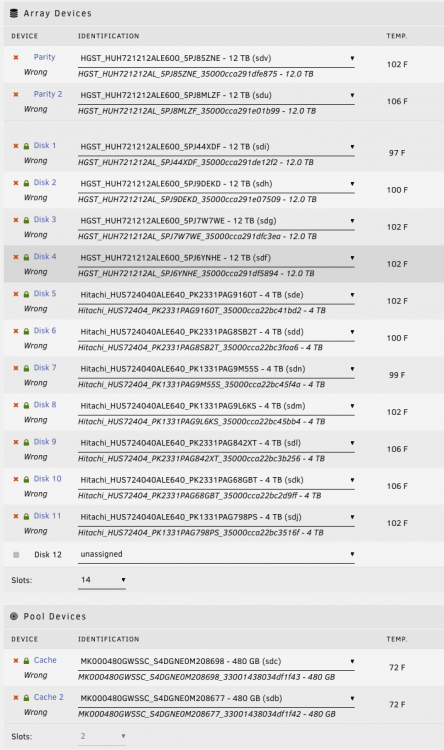

I've been running 6.9.2 since initial release on this same hardware, so no changes before upgrade today. I'm running on an HPE DL380Gen9 with current BIOS and SPP and all parity and data drives on my LSI HBA card (LSI SAS3008), while both cache SSDs are on the Smart Array P440ar running in HBA mode. All drives (Parity, data, and cache) after the update are now identified with the "short" names, whereas before the upgrade they were all using the "long" names.
  - v6.9.2 -  Parity 1 - HGST_HUH721212AL_5PJ85ZNE_35000cca291dfe875 - 12.0 TB
  - v9.10.0 - Parity 1 - HGST_HUH721212AL600_5PJ85ZNE - 12.0 TB
I had this happen before when I replaced my older PERC H310 card that was flashed, just the other way around.
I know I'm going to have to run a "clean" config now, which will kick off a parity sync, but what happens with BTRFS since both SSDs are showing as wrong? Will unRAID right itself once the pool comes back online, or will I have to restore cache from a backup? Screenshot and diag file attached.
tower20-diagnostics-20220520-1335.zip
