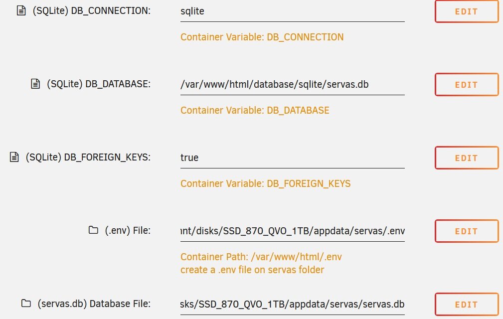

I'm using Servas with SQlite on Unraid and I'm very happy with it so far. A few days ago I updated to Version 0.5. Since then I'm unable to get to the login page. I always get an Errorcode 500. I read the instructions (https://github.com/beromir/Servas/releases/tag/v0.5.0) according to the change where path for env changed but I don't understand what I have to do.
Attached is a picture of my current settings (unchanged) for Servas.
Can someone help me with this problem?
Hi@Armadageddon ,
"The project root in the Docker container is now /app. You have to adjust the volume mapping of the .env file in the compose.yaml file: ./.env:/app/.env."
You need to edit "(.env) File" section and change Container Path:  /var/www/html/.env to /app/.env if i'm not wrong that it ;)

@HuSoSThanks for your clarification!
I tried to start from scratch and did the following:
- created .env file (with APP_KEY= in it) in appdata/servas/
- created servas.db in appddata/servas
This leads to a error code 500.
Then I changed the settings according to your suggestion. Unfortunately I still get the error code 500.
I thought, when I set it up from scratch, that it should be possible to just swap out the servas.db file.
Sadly the app does not work out of the box anymore...
