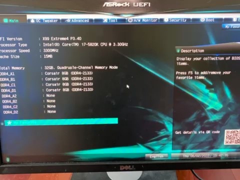

I am still getting an intermittent issue where sometimes my server will boot up without any issues or will attempt to boot up and I wind up with this screen:

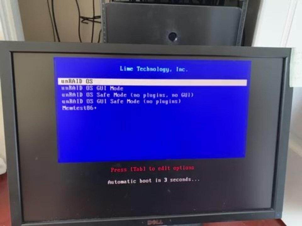

I have a dual mount USB adapter on the mother board.  If I unseat the adapter and reseat it, it seems to boot successfully and I temporarily get the following screen:Boot1.jpg.2680408216f1cfa75592749bdbaa49c9.jpg
The blue section in the bios screen is hard to read but says "My Favorite" and it looks like it is giving me the option to delete it.  Is that something I should do?  Even though I reseat the USB adapter, it does not always boot properly...color me perplexed.
It shouldn't make any difference, you'll see the BIOS screen when a boot device is not found, try a different USB port/hub and make sure it's USB 2.0.
