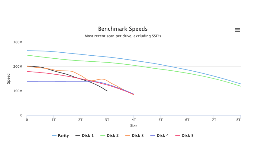

sdesbure Posted May 31, 2022 Share Posted May 31, 2022 Hello, I'm using an 88SE9215 marvel controller for 4 of 7 disks. It seems to work OK (the drives are the bottom except "purple" one + cache) but we can see that the speed is lower. I was thinking to move the drive to an LSI controller. Can I do it by just swapping the cards (and changing the cables)? Quote Link to comment
JorgeB Posted May 31, 2022 Share Posted May 31, 2022 2 hours ago, sdesbure said: Can I do it by just swapping the cards (and changing the cables)? Yes, if the HBA is in IT mode. Quote Link to comment
sdesbure Posted May 31, 2022 Author Share Posted May 31, 2022 yep, that's what I was planning to use (an HBA working out of the box) thanks! Quote Link to comment
