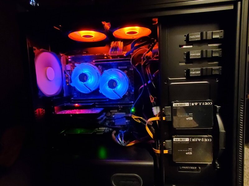

The upgrade from 6.9.2 to 6.10.0 and then 6.10.1 and finally 6.10.2 went off without a hitch.  I read the release notes and didn't encounter any issues.  I'm sorry that the photos below are a bit dark and dusty but I wanted to take them without shutting down the server so this is the best I could do.

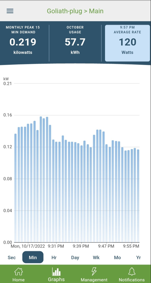

I just bought an smart plug energy meter and will update this post after I have run it for a bit of time and have power consumption numbers for you.
It's averaging about 125 watts when idle.
Peak usage was 229 watts.
Over the past week, it has averaged about 2.6 kWh per day.

I get my power usage stats from the smart plug I have the server connected to.

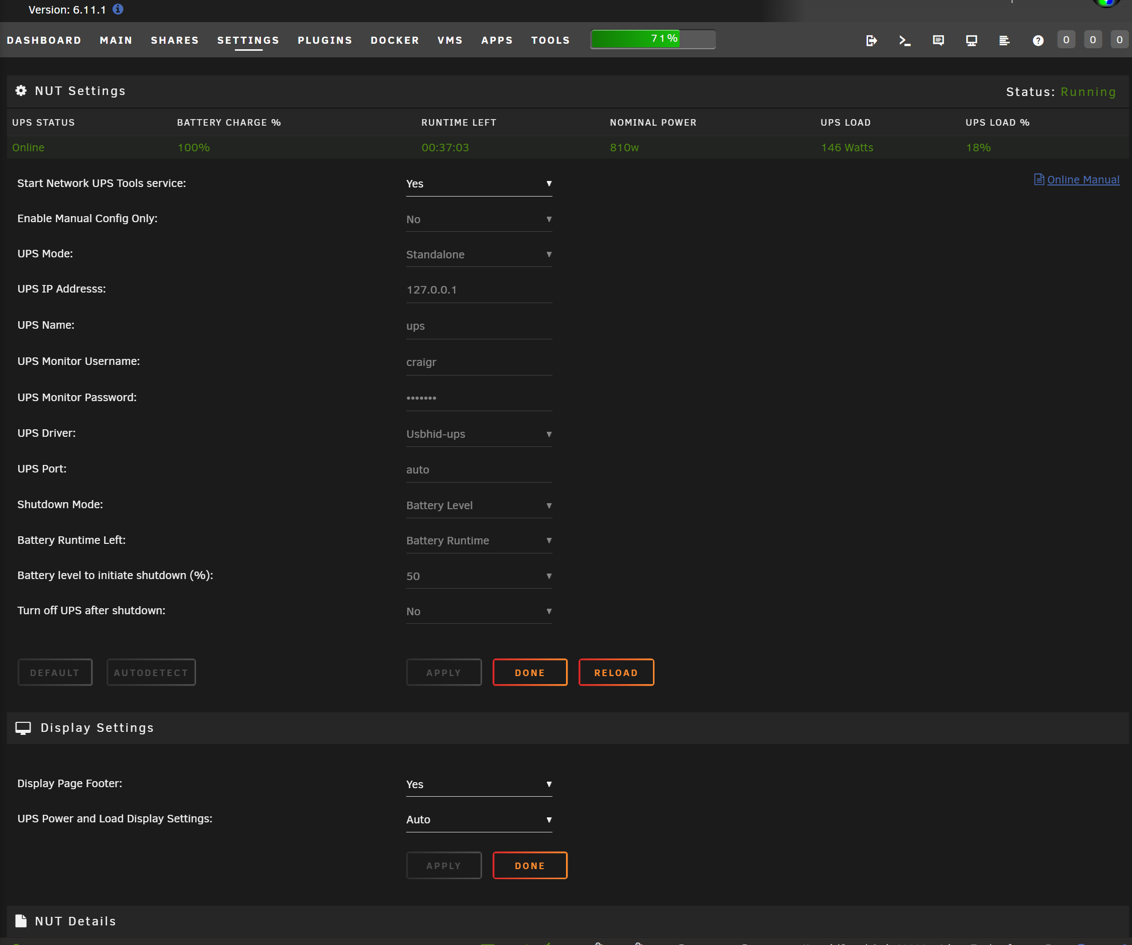

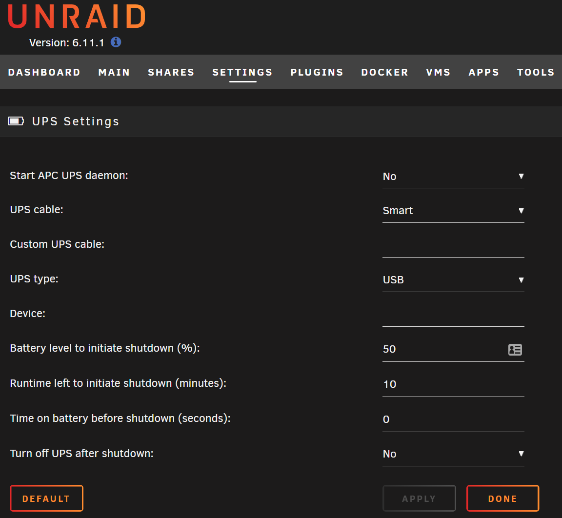

Depending on your UPS and whether or not it's buggy with unRAID you have two options to monitor power and shutdown unRAID.  This first is built in; Settings > UPS Settings:

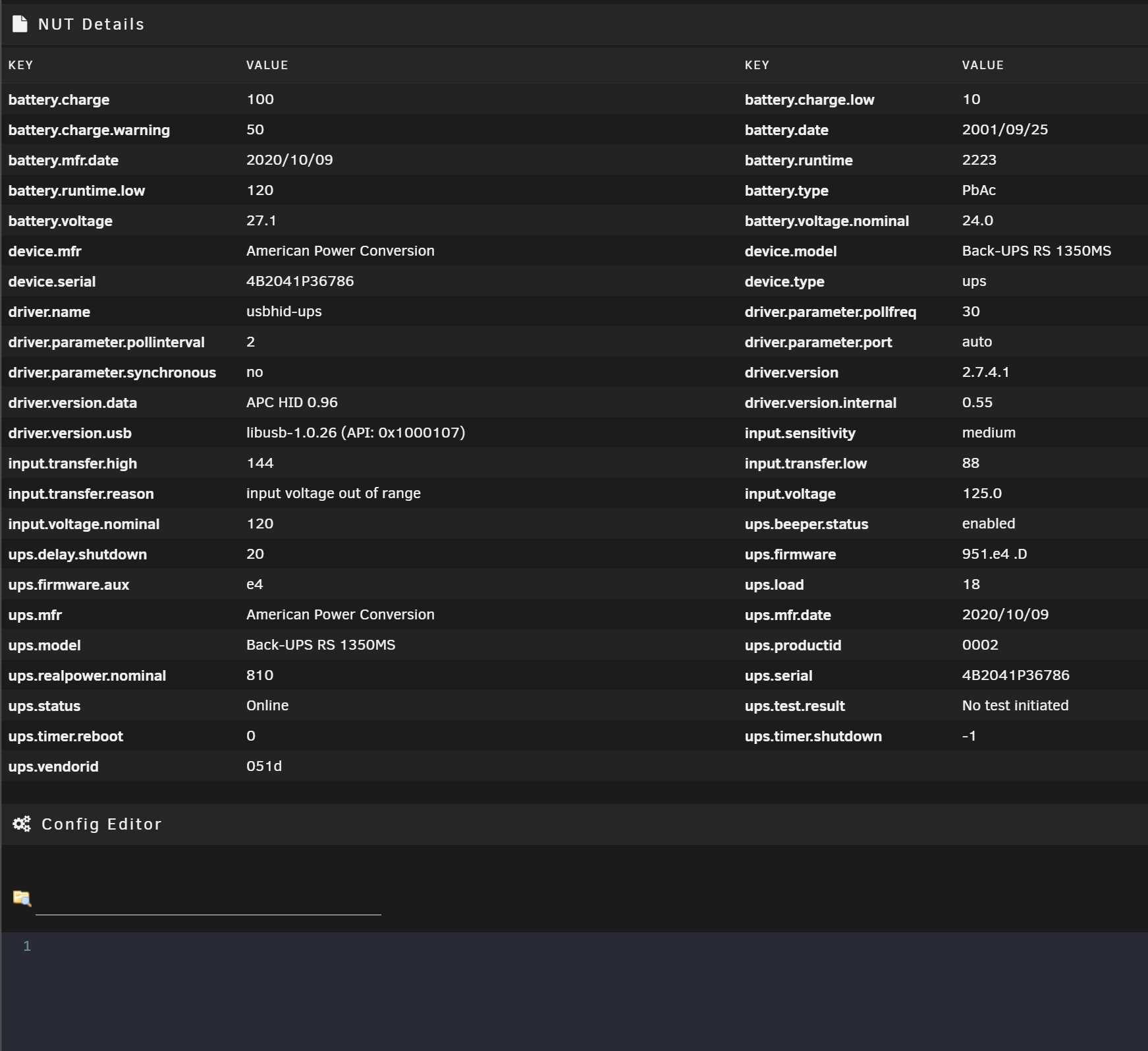

That worked for me until I upgraded my UPS and unRAID thought the UPS was disconnecting multiple times each day.  I then switch to the app call NUT which you may download and install through community applications.  It has more capabilities and has worked much better for me:
Both are pretty easy to setup and use.
Enjoy and let me know!
