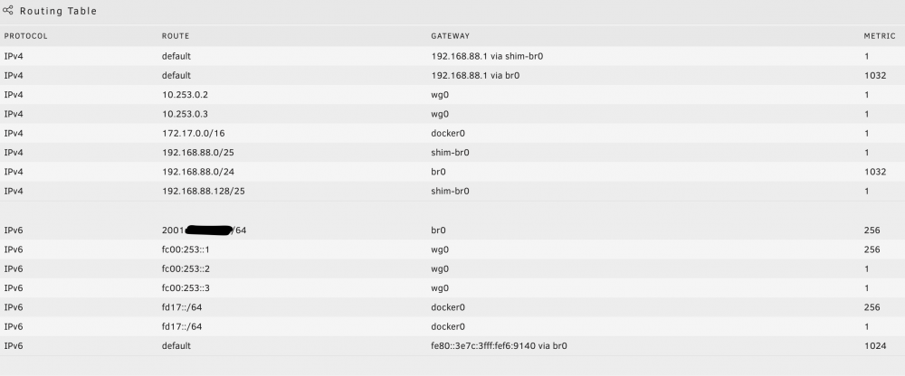

My server runs 6.10.2 and host access to custom network settings are enabled. Unfortunately it seems to work only via ipv4. If I remember correctly It used to work with both ipv4 and ipv6 on 6.10 RC.
I have checked IPv6 routing table and there is nothing related to shim-br0 interface (see the ss).
Any ideas?

Host access works for ipv4 only, the ipv6 part was removed because it caused interference with other ipv6 related activities, which could break the communication.
can it be solved?
