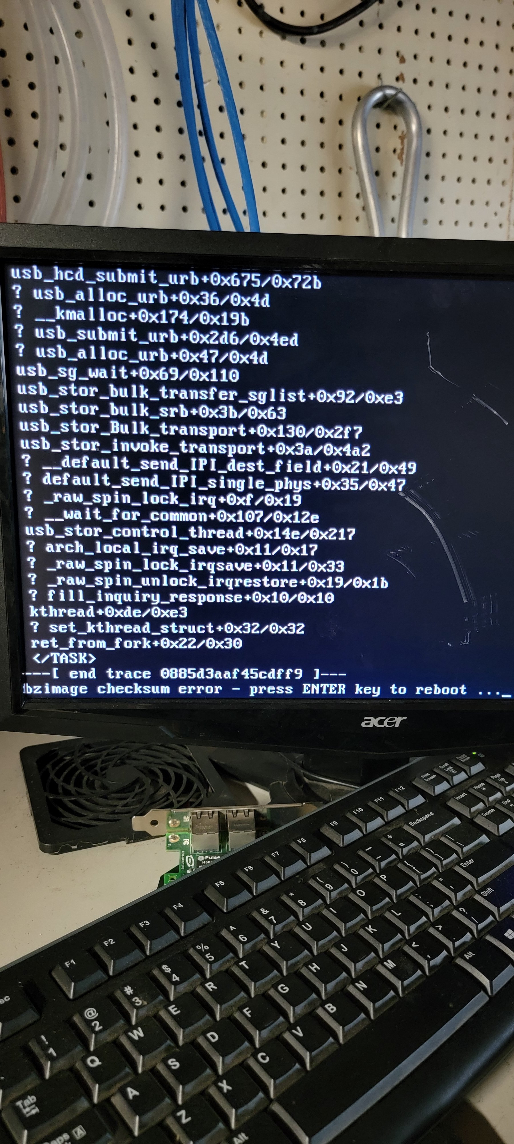

Boot error (check sum)
Is my USB dying? I thought a reboot would automatically fix it but it didn't. All I did was turn it off for an update turned on fine and logged in. Turned off again to put in a 10gb nic and this happen. I've used this exact Nic in this system before
I also tried booting into safe mode. but I get the same error message

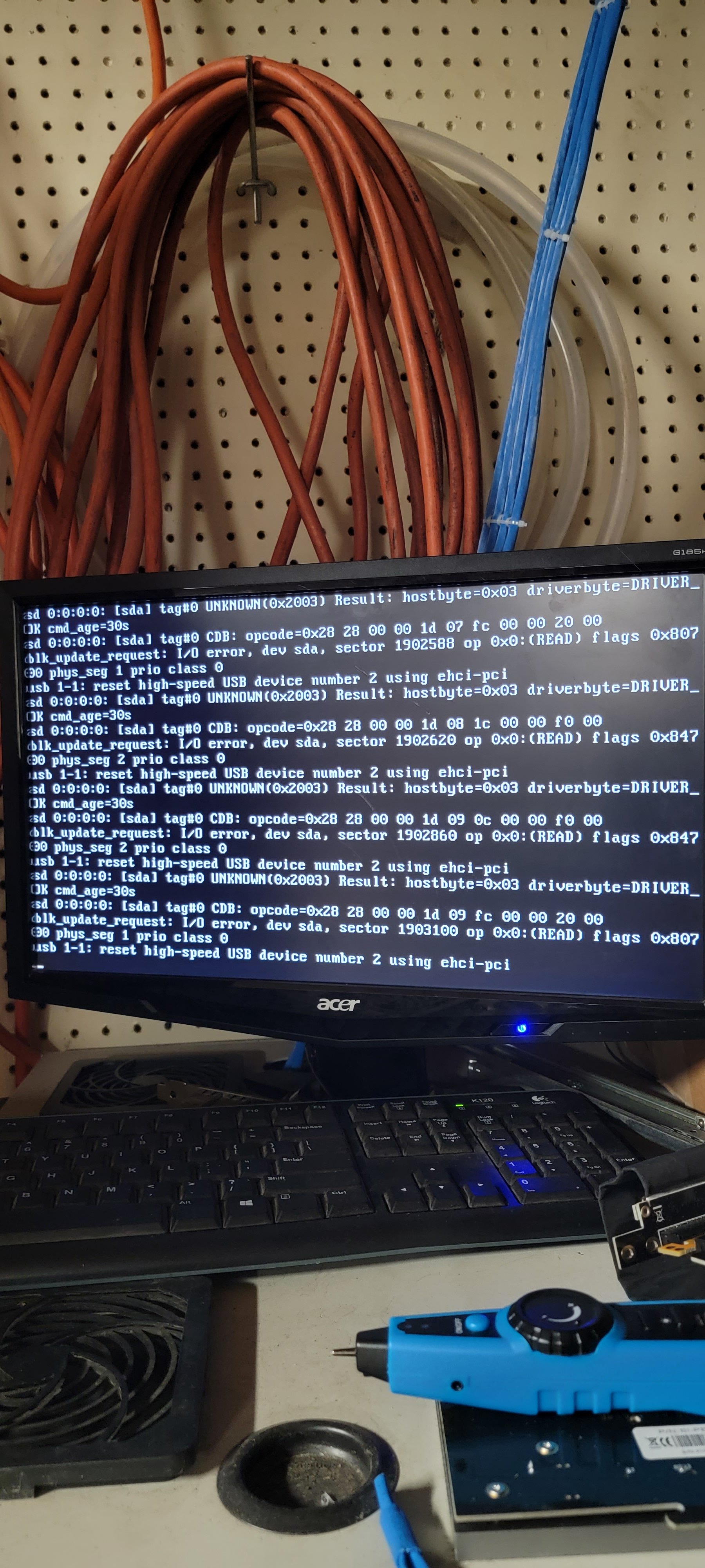

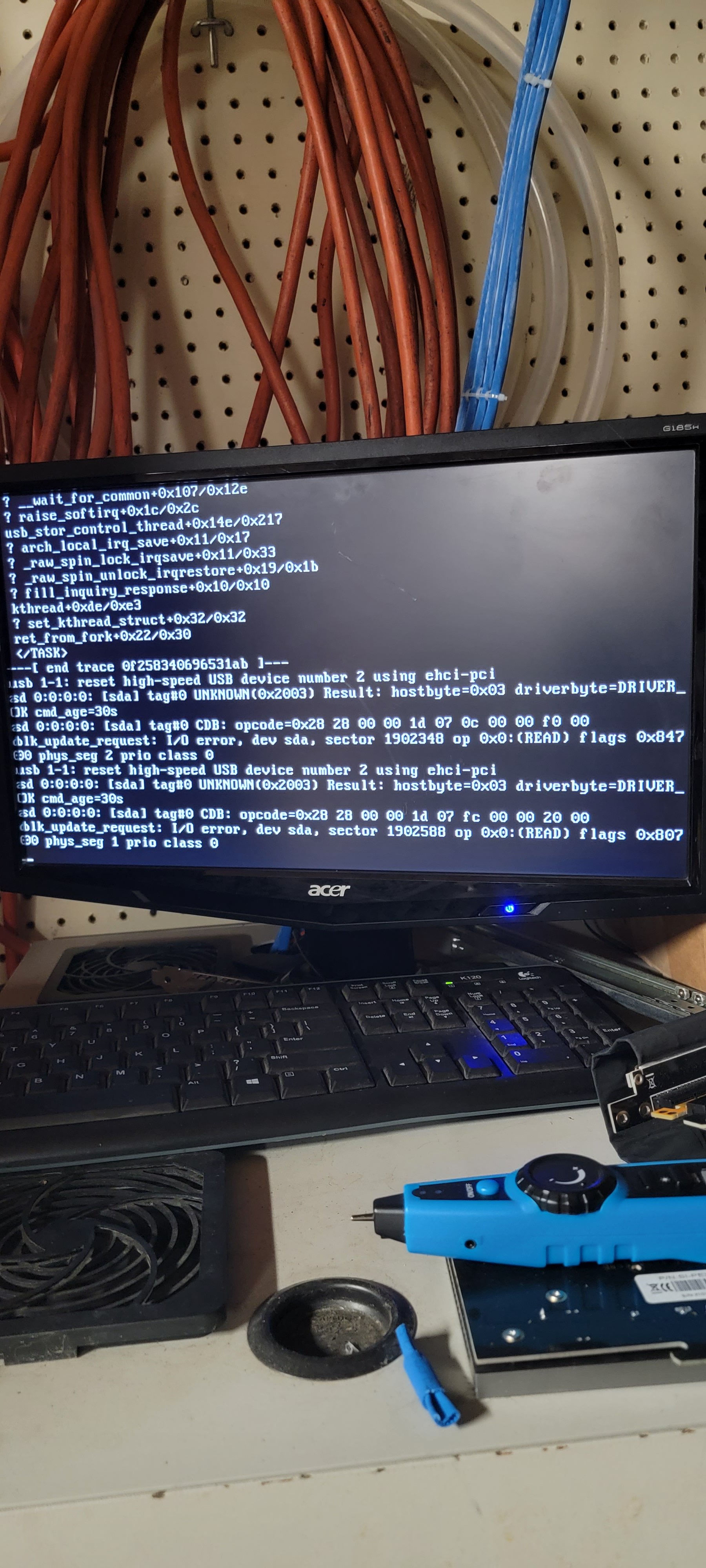

I'm still waiting to hear back from unraid support but I again rebooted my system and now I'm getting this error any ideas what it is
The errors on sda are read failures on the flash drive.   Is this a new drive or did you try rewriting the original one?
It's the new drive that I've used for other things but erased everything on it to make it my new unraid boot Drive. I'm currently trying a third Drive that I didn't want to get rid of.

Are you using the USB Creator tool to create the drive or using the manual method.  If using the Creator tool then it could be worth trying again using the Manual method - in my experience it can be more reliable for some reason,
It could also be worth trying a different USB port on the server in case the one you have been using is becoming faulty.

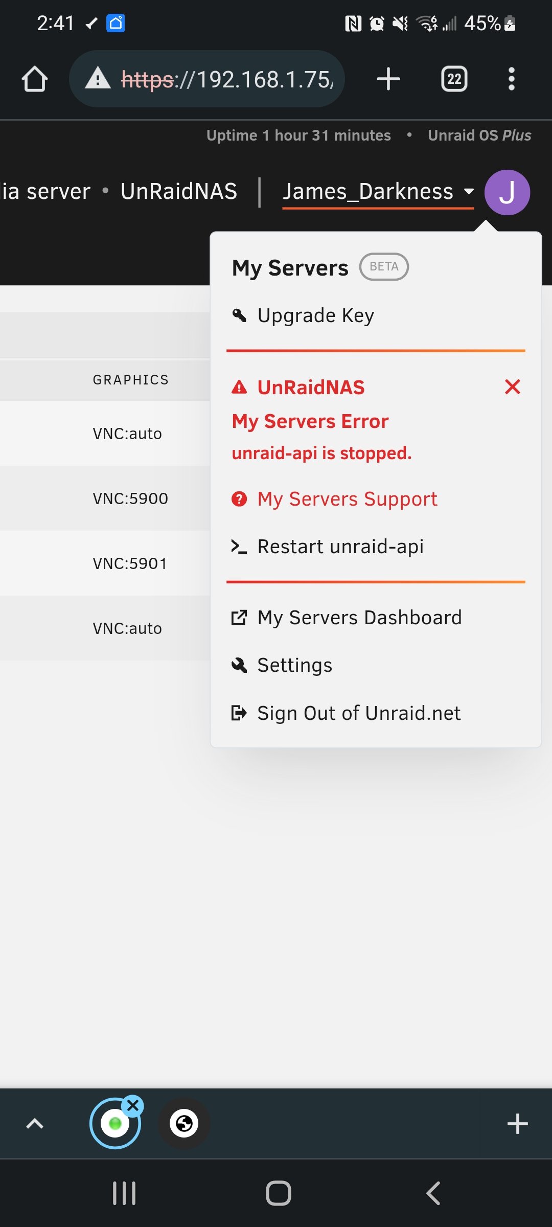

Unfortunately I did it just took awhile for it to take affect/didn't know what i was doing. But I had that unraid API error as shown above
