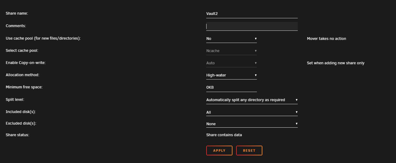

Do you know what Vault2 is? It doesn't exist in any array/pool device.

its a share made with unraids gui. I mounted some folders within the share. I was actually just looking at that error and found I shouldn't be mounting under /mnt/user/. Does this include within the share itself? ex (mount /mnt/user/Vault2/Somefolder/)?
Yes.
9 minutes ago, JorgeB said:
Yes.
Okay thanks! I have corrected this and no longer receiving that error and will further monitor it. Will that inadvertently cause the libvirtd.log to fill up as well?
