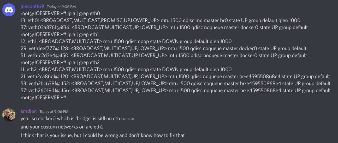

But tonight I decided to try and troubleshoot my nextcloud docker container. With the help of smdion in the discord we figured out that Unraid has some very strange network things going on. So I'll attach a diagnostic. If I can answer any more questions please lmk.

Don't see anything strange with the network config, though you are using eth2 as the main NIC with bonding and there's no link on the other two NICs, just to rule out some issues with that I would suggest setting eth2 as eth0 and disabling bonding to see if it makes any difference.

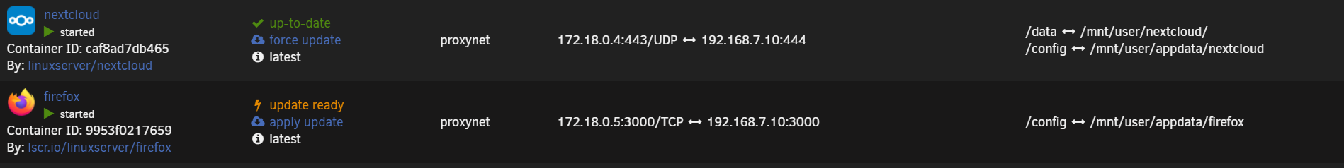

Firefox can access nextcloud @HTTPS://172.18.0.4:443 but nothing can access it from HTTPS://192.168.7.10:444. Why is this? I wish I understood better. I'm still trying to learn.image.thumb.png.5e8b1ee79f26864417ce473c83a88dd5.png

4 hours ago, joecool169 said:
It seems like I have all my issues sorted out. Changing these network settings you suggested fixed the network issues.
Deleting and reinstalling the nextcloud container fixed my issues there - still not sure what was wrong with it
And my usb flash was failing for the 3rd time. Not sure why these do not last, first one was a cheap micro center one, the last 2 were Samsung's
But now I can not choose br0 as a network in my docker container configs and therefore can't select a custom ip address for pihole.
I figured this out on my own,
I went to unraid settings, stopped docker, and then checked the box for custom data network br0
