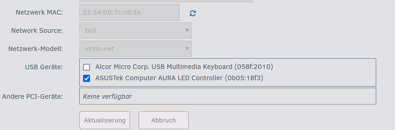

AURA shows up like an own device, just click it on in the VM settings to pass it.

yes and no.
The passing works flawlessly, the AURA software not (its crap!). This is because AURA is a mixup and depends on more than just this USB Device.
If you just want access to the LEDs, install OpenRGB Software, either on unraid as a docker or inside a VM as the windows version.
I dont like dockers (and it turned out to be unstable too), so I pass the device to a windows VM with OpenRGB. OpenRGB is a network service, so you can manage it from anywhere. I use a small python script on UNRAID to read current temps and system load and transform them into colors / LED bars passing them to the OpenRGB server.
This works great and stable for months now.
