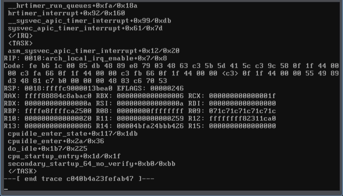

Hello, I recently updated the server to the newest version, and now I am seeing frequent crashes of the system. Not sure what is happening here, but I've attached a screenshot from the KVM and the syslog. Should I downgrade the system again? Or is there possibly something wrong with one of my disks?
Thank you!

Nothing obvious in the log, please post the diagnostics so we can see the hardware used.
Again nothing obvious, no known issues with the hardware you're using that I know of, do you now the exact time it last crashed, just in case I missed something in the syslog.
Unfortunately I do not know the exact time. Not sure if the screenshot from the KVM is also helpful? This appears to have started after I upgraded the OS to the latest RC.

Nope, there's no time code, you can try again, take note of the time it crashes and upload a new syslog, another thing you can try is to boot the server in safe mode with all docker/VMs disable, let it run as a basic NAS for a few days, if it still crashes it's likely a hardware problem, if it doesn't start turning on the other services one by one.
