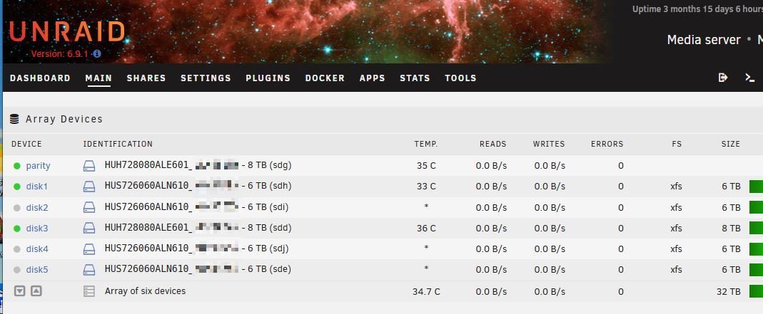

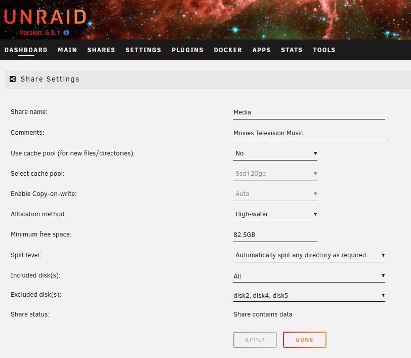

I think I understand what you are asking.  I had a similar want, and this is how I configured my server.
I have 5 data disks + 1 parity in my array.  My server is used for media (Plex), multiple computer backup, a large photo depository, and Nextcloud. I wished for my media share to always be spun up, as the delay to spin up the drives was annoying.  I wanted the rest of the drives to stay spun down unless needed, which is infrequent.
My media library currently fits on 2 of my data drives.  I have a share /Media, and configured the Share Settings to exclude all but the 2 drives which have my media files.  (I manually moved all of the files that were on the other drives to these 2 drives).  I set these two drives to never spin down, the others for a 15 minute spin down delay.
Now, when Plex does any maintenance, it only accesses the 2 drives that have media files (which are always spinning).  The 3 other drives remain spun down.
