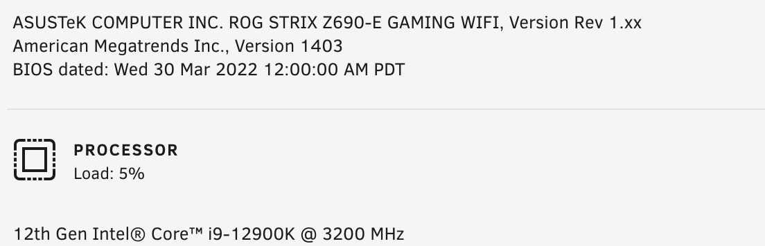

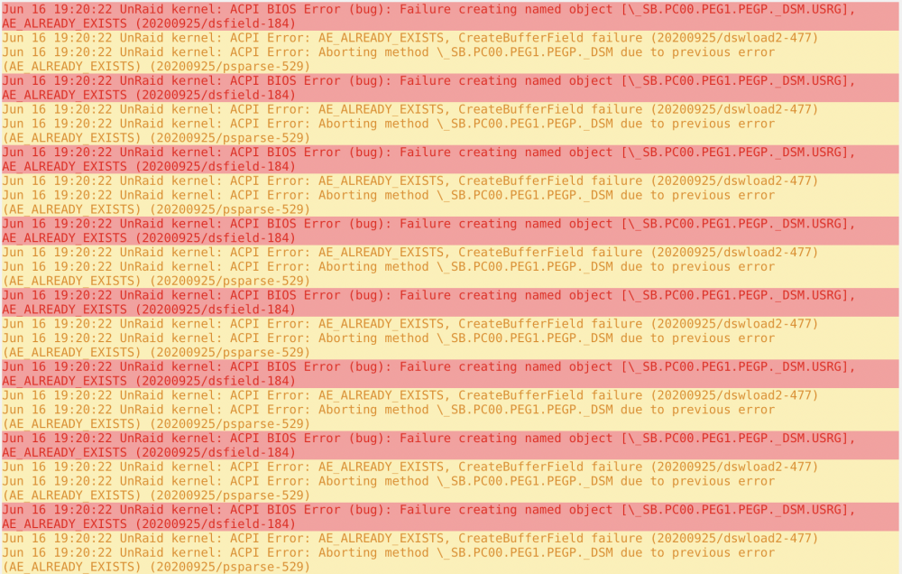

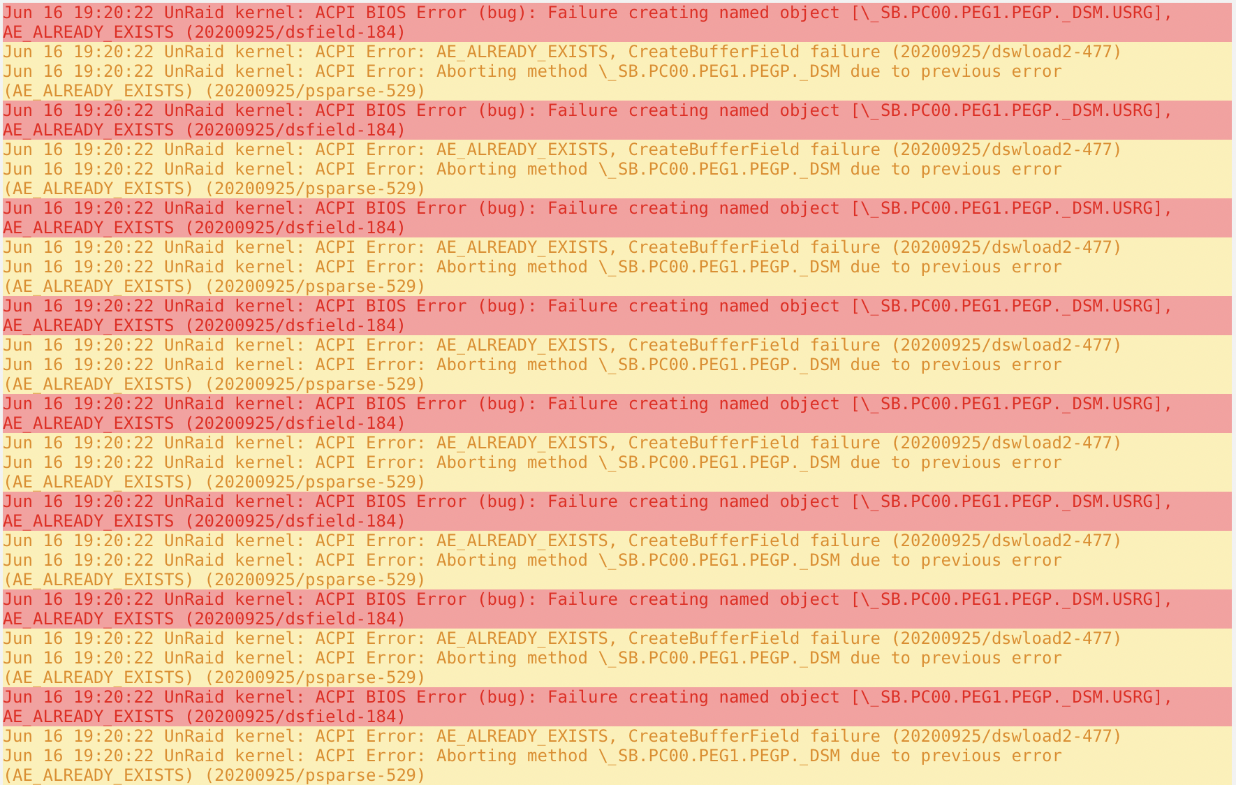

I appreciate  the hard work for the DEV and unraid.  My unraid server has been freezing up on me more and more after i reverted from 6.10 back to 6.9.2 . I am considering move to 6.10.3  but unsure why i have these issues. if anyone can help would be cool.

Look for a BIOS update to see if it helps with that log spam, then enable the syslog server and post that after a crash.

Unfortunately the log is still being spammed, and don't see anything relevant to a crash, do you know the time it crashed?

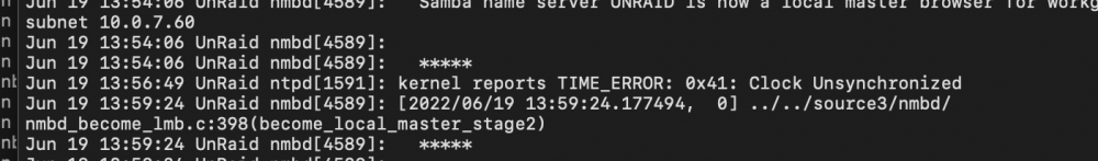

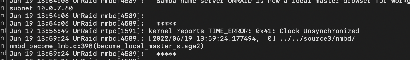

new crash log. I did see there a time sync issue. I dont know if that can cause it717296681_ScreenShot2022-06-19at2_23_44PM.thumb.png.004acd6801a438ef7ffaa038c02d43a0.png
