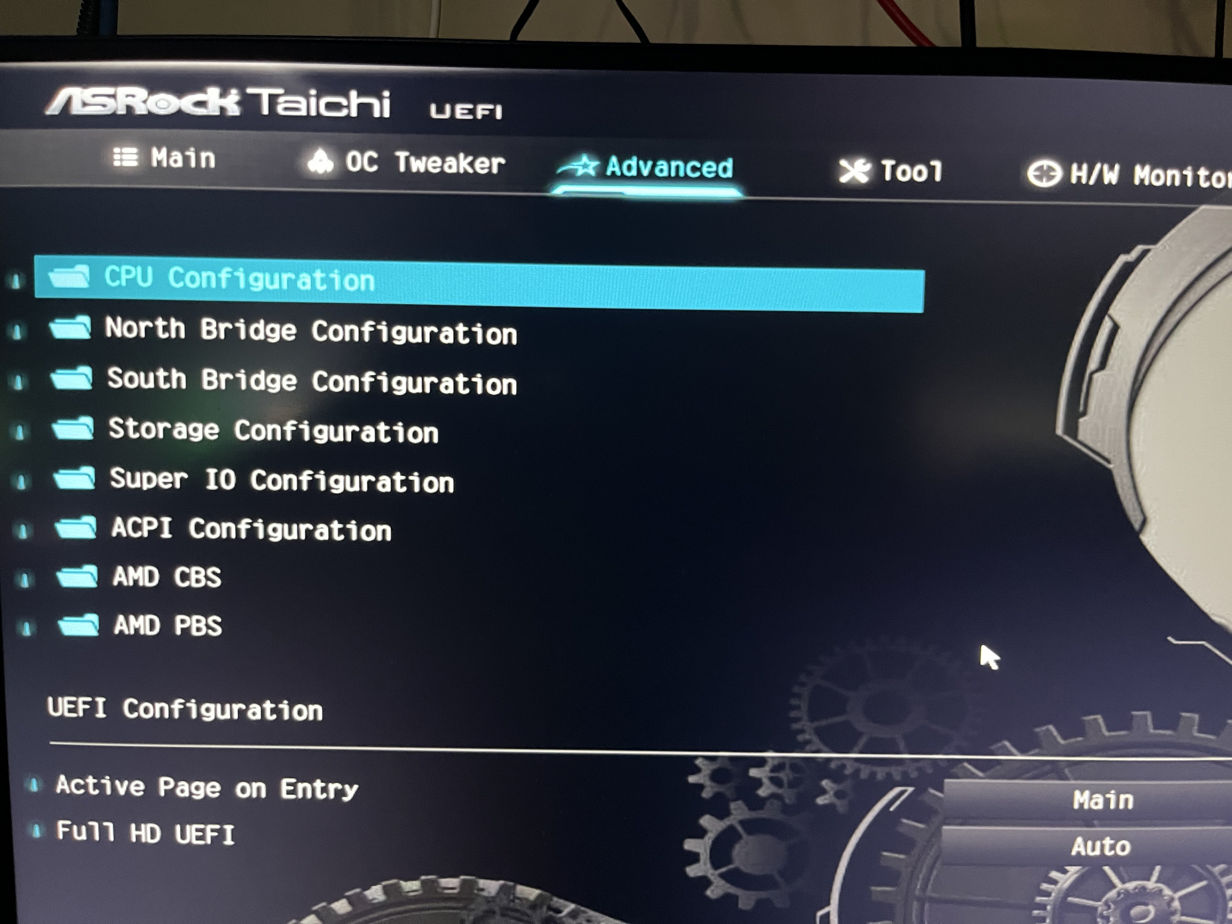

I was able to set RAM to 1866 but couldn't find an option to handle power supply idle control or c-states. I tried this:
Started here and picked "CPU Configuration"

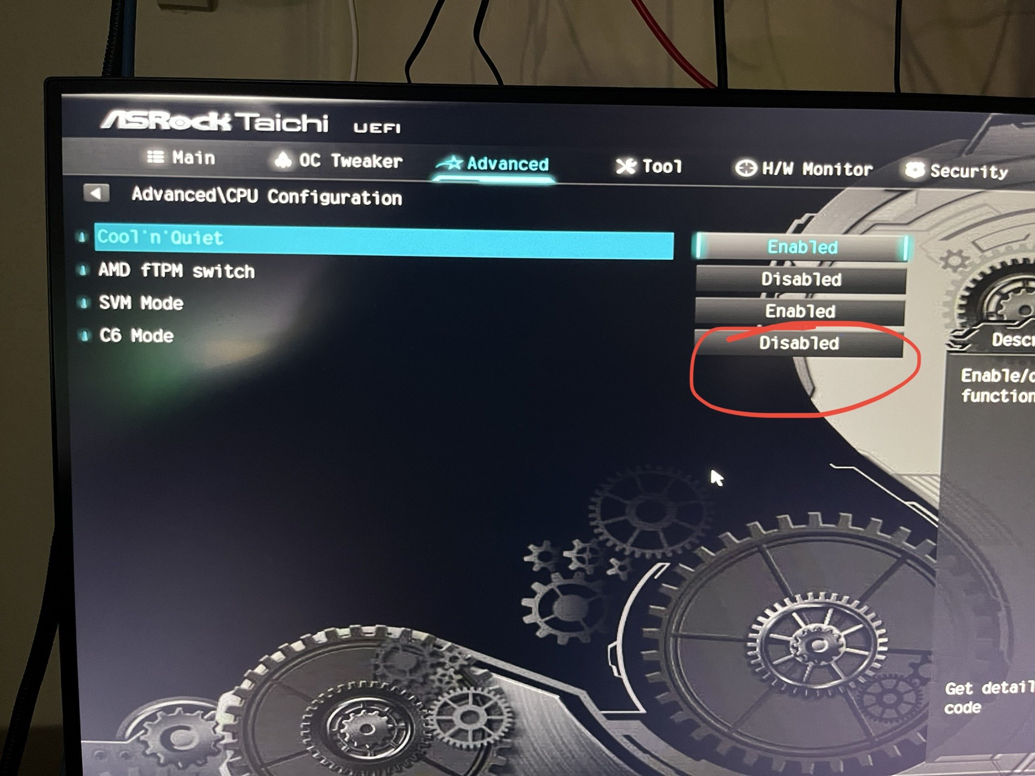

Once in there, I changed C6 mode from "enabled" to "disabled."
