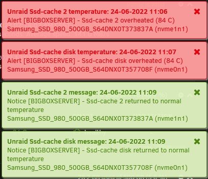

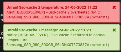

There has been one issue though; both my cache SSDs seem to often be spiking to 84°C, only to go back to normal temperatures minutes or even seconds after. It's always a spike too, they don't gradually get hotter or colder. This even happens when they are not being written to / read from. This seems like a false positive to me, only I can't figure out what's causing it. I carefully touched one of the SSDs while it was supposedly overheating and the temps felt perfectly normal.

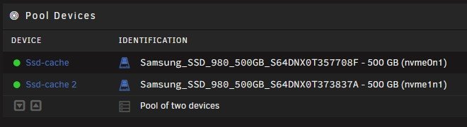

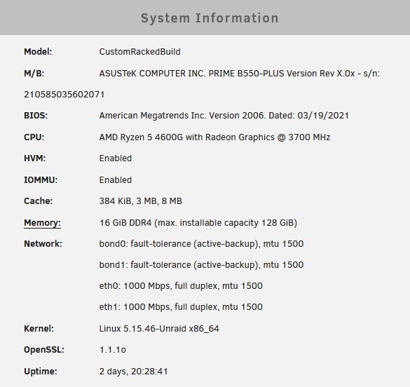

I've attached some screenshots with more info. (specs, notifications, motherboard, ...)

This is a known issue with Samsung SSDs.   I believe that the 84C message is spurious, but what actually triggers it I have no idea.
Alright, good to know that it's a known issue. As long as it's spurious, it's just a minor annoyance and not a problem. Hope there will be a fix for it at some point.
