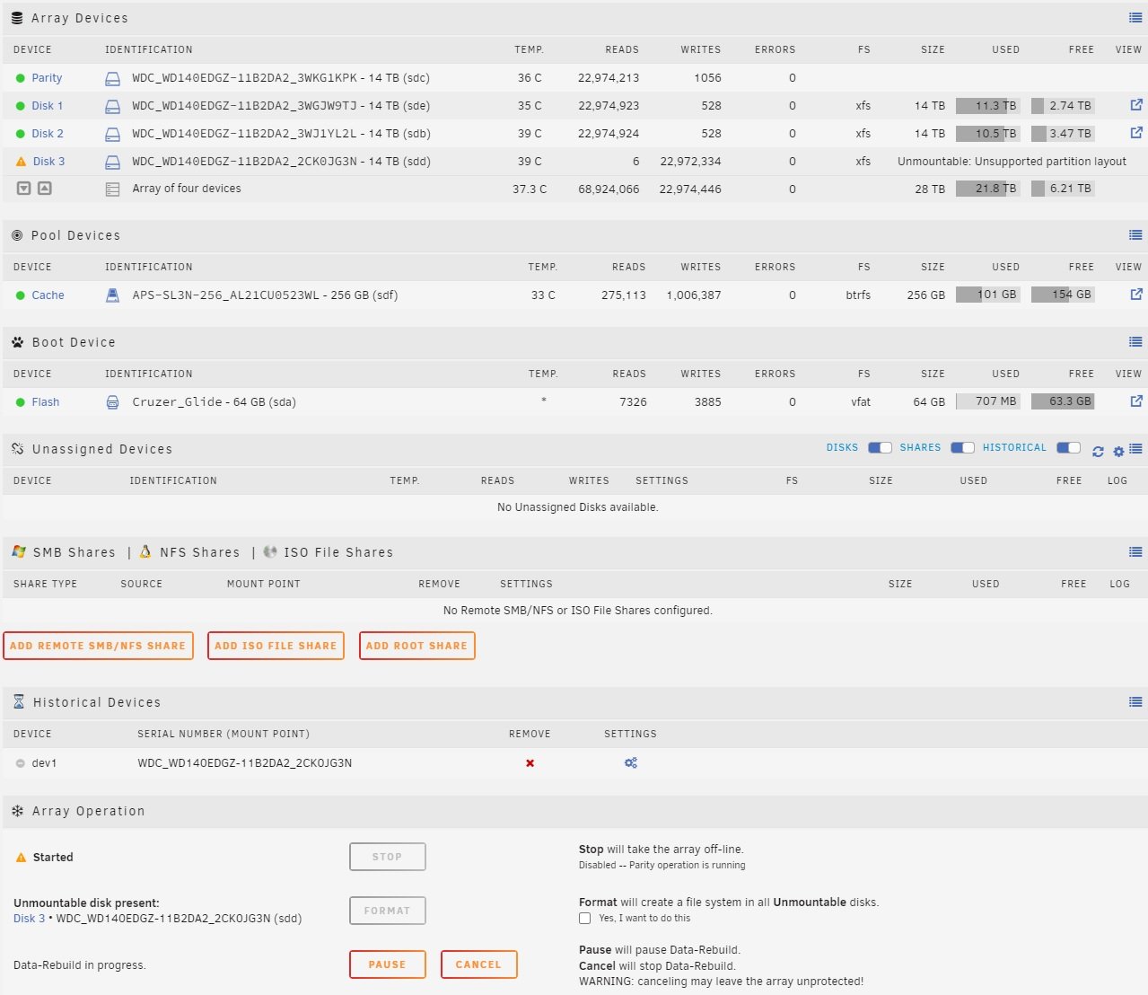

I added a 3rd data drive to my array, and went about how I normally do it. After it was added, Unraid went through the process of clearing it, and once it was done I formatted it, but after the format it still said it was unmountable. I tried this several times with no results. So, I figured I would take it back out of the array and see if there was something I could do in Unassigned Devices, but that was apparently a mistake, because then Unraid saw the disk was missing and started emulating it, even though it was never mounted in the first place. So I added the disk back to the array and it has begun a parity rebuild. Currently, as shown in the screenshot, the drive is still shown as unmountable. So what exactly will happen once the rebuild is done? I'm assuming it will still be unmountable. Is there something I'm doing wrong here? Untitled.thumb.jpg.0e25f2b1e03809a814390edd23d20f64.jpg

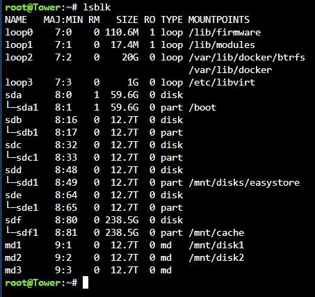

What do you get from the command line with this?
lsblk

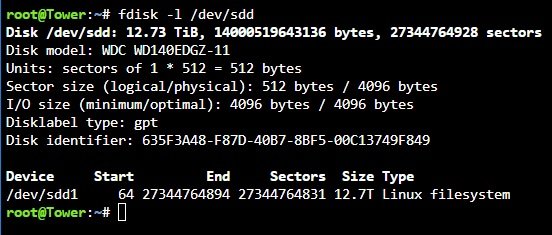

And what do you get with this?
fdisk -l /dev/sdd

fdisk -l /dev/sdd
Looks normal to me. Maybe someone else will have some ideas.
When you started the array with disk3 emulated it mounted, suggesting the problem is the disk not accepting the correct partition layout, you can try clearing or preclearing the disk and try again, but there could be some other issue.
So should I let it continue rebuilding the parity before trying anything else? It wouldn't be so bad if it didn't take so damn long. Also, is there a way to remove that disk without it requiring a parity rebuild? Like, just revert it back to the way it was before I installed that drive?
You can cancel, it won't work in the end anyway.

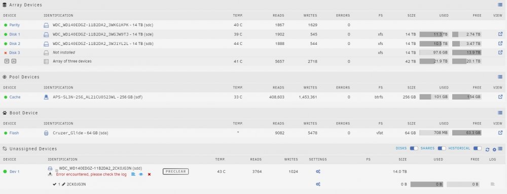

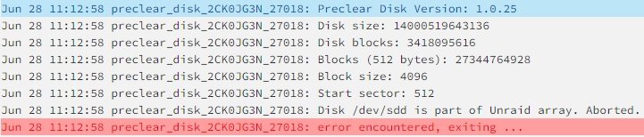

Okay, so I stopped the rebuild, stopped the array and took the disk out of the array and into unassigned devices. I then tried pre-clearing it, but got this error message: Disk /dev/sdd is part of Unraid array. Aborted.
Is there anyway around this? If not, what are my other options? Will I just have to buy another drive?
Start the array without the disk, preclear should work then.
That's how I did it, but still got the error.
There was a preclear error, that's a different issue, check or post the preclear log.
Reboot, it's no longer part of the array.
