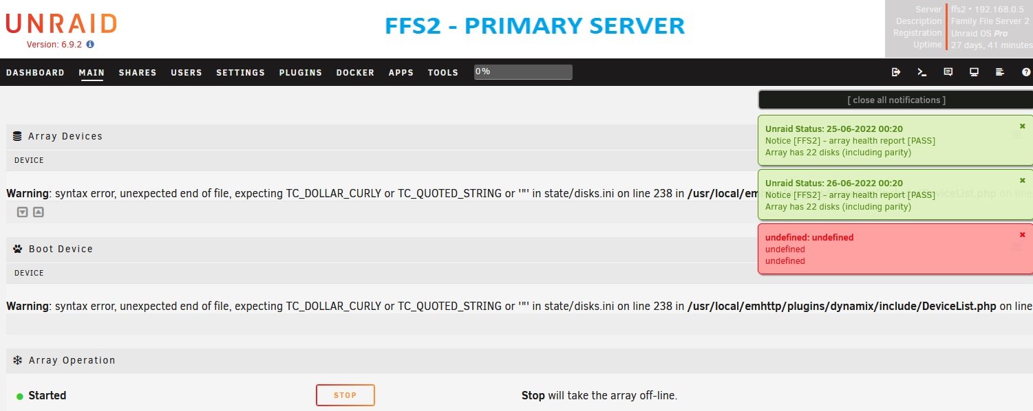

GUI is kaput
Every day is something new and broken.  I may need to totally start from scratch and build a new server.
Shares are accessible via Samba shares, Windows Explorer.  ssh works fine.
GUI looks like this on three different browsers (attached.)

May have found the issue.......
What is this supposed to look like?

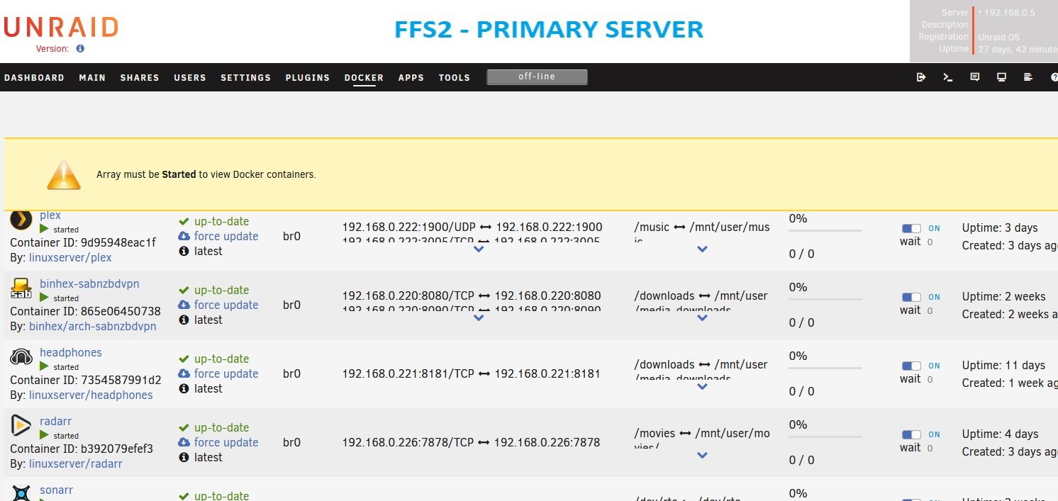

I rebooted.
Unassigned Devices didn't mount my ssd, so now the docker failed to start.  In fact, Unassigned Devices isn't even visible in the main screen anymore.  When I go into apps -> unassigned devices -> settings, the URL displays correctly but the screen is blank.  Never loads.
