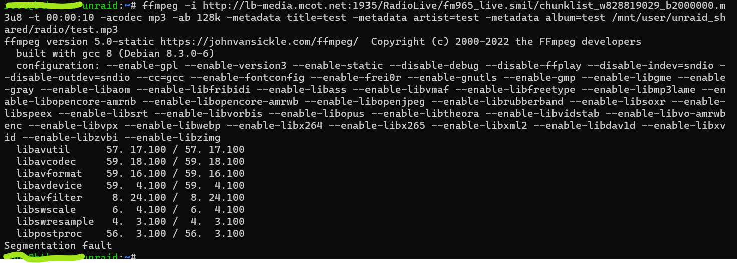

I installed ffmpeg in my Unraid as a native app (wget https://johnvansickle.com/ffmpeg/releases/ffmpeg-release-amd64-static.tar.xz ) a while back in order to create a script to record fm online radio with user script plugin. It has been working fine until after I upgraded my Unraid to the newest version.
As soon as the script run the ffmpeg command, it stops immediately with "segmentation fault" error, without any other error information.
Anyone has experienced the same and has any solution to this?
