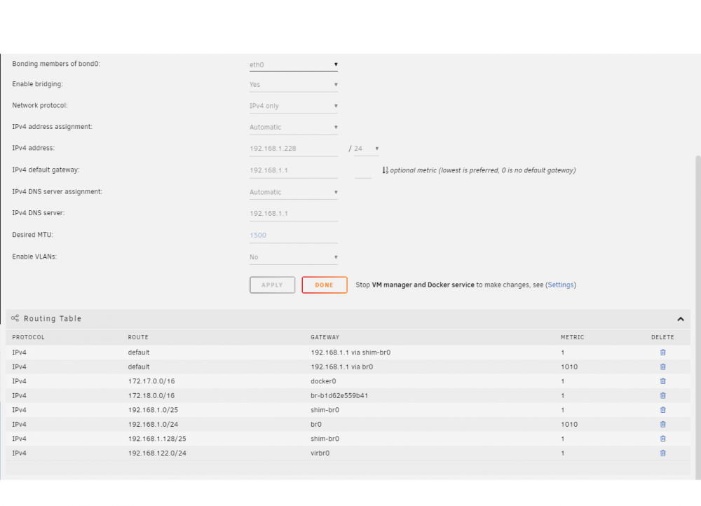

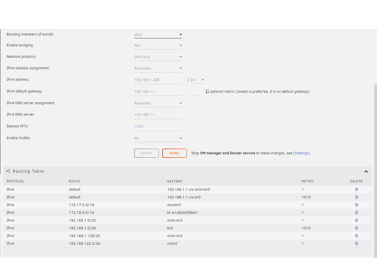

Therefore I think both have the same issue. This is what I found. I must have messed up with my network config within unraid. This presented itself when I rebooted.
One is showing the same IP as the unraid server but a MAC address I cannot find. If I block that new mac from the router level I loose unraid GUI. Maybe somone can help looking at my network settings and see what I need to do.
